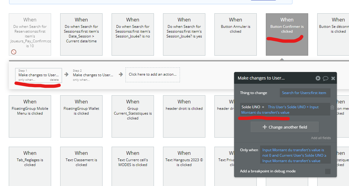

Screenshots :
This should be Solde UNO = Search for Users:first item + input value no?
Hey @jefeoliveira22 thanks for the reply, I tried it already (and tried once again right now to be sure) but behaviour stays the same… This user (receiver)'s wallet amount always becomes “input value” while the sender’s wallet is updated the right way :frowning:

I have tried all of this and had no changes, then I don’t know why I tought about “privacy” settings and “auto-binding” option
I chose “auto-binding” on “input transfer” as shown on the screenshot, then on privacy settings I allowed autobinding for “solde UNO” (the wallet points) and now it f**** works, such a pain to solve :smiling_face_with_tear: Thank you very much @jefeoliveira22 for your help !! I hope this can help other people
