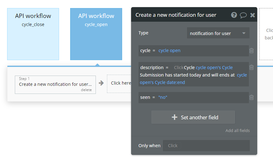

so i have the admin page, and when the admin is create a new calendar academic and submit i want it to send notification on the date where the new academic calendar date is start, and send notification to tell the end of the academic calendar.
i’ve been try with backend workflow and scheduling list workflow.
how can i send notif to all user?

Create a workflow and iterate through the list of users. You don’t want them all to go out simultaneously. In programming it’s called a loop, I’m pretty new to bubble, but this video seems to explain it pretty well from a no-code perspective.
You have to create a recursive api workflow.
You essentially need an api workflow that creates a notification for the user you give it, then it has to call itself again with the next user.
Here is an example I use in my project, where I’m passing through an index (1, 2, 3, 4…) and process stuff for User#(1, 2, 3, 4…) in the database. Repeating the same process until I run out of users to process.
Just be aware that this process is slow! Hundreds of users will take considerable time…

@nick27 @chiprana @gerbertdelangen sorry for late reply, thank you guys for the solution. after my trial and error with recursive workflow i got the formula for my schedule date.
thanks in advance. very helpful.

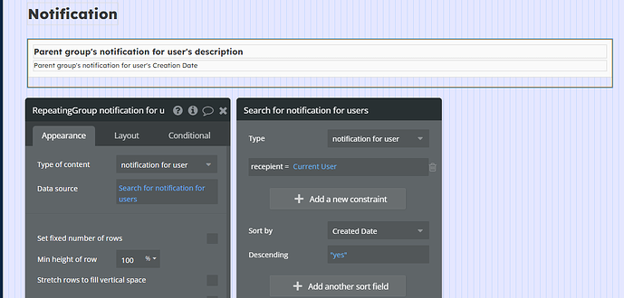

@chiprana one more question, in my database look like this,
should i change it to list? cause if i have a 100+ user my database will be to much coloumn like this.

This seems okay to me. Each notification should be a separate record in the database. You can have millions of records in a database table, do not worry about that, that is exactly what they are made for.
oh okay thank you, i just worried about the perfomance when it goes live.
thank’s a lot @chiprana.

@chiprana @gerbertdelangen sorry for asking again,
how if i send notification to particular user? should i create the new one (with different message). im trying and don’t know how to send it to particular user, i use do a search for but isn’t working.
so the idea is when user create project then submit project, i want the department who have a job to review the project get the notification.
