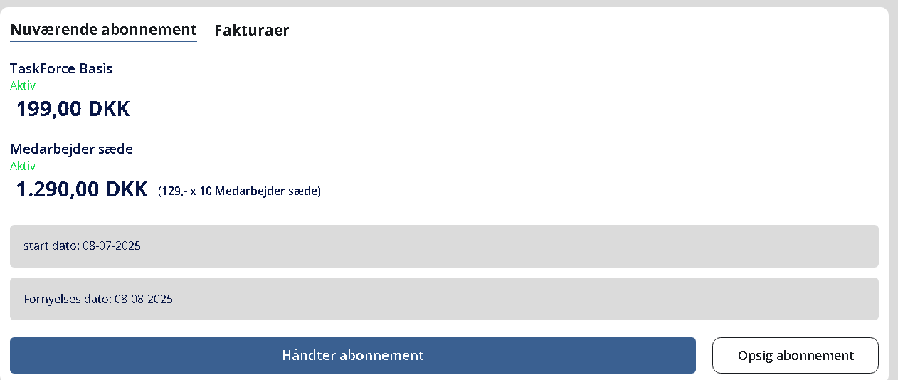

right now i have this setup to display the active subscriptions that the users have.. but when i click to manage subscription and get in to the customer portal
i can update the secondary subscription called “medarbejder sæde” to a main subscription of basic or pro.. and that shouldnt be possible.. the secondary subscription should only have the option to change the quantiy of them

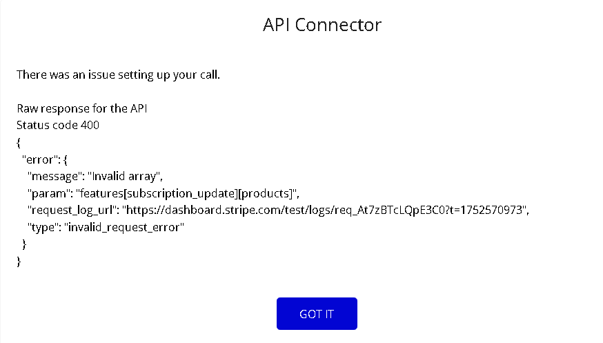

im trying now to make a new portal configuration with an API and then in hope i can use that portal configuration id in the portal session
but im getting this error i dont understand.. im following there API here: Create a portal configuration | Stripe API Reference
and i want to use the array: features.subscription_update.products to define what products there can be updated
but it says its a invalid array..???
this is my setup:
