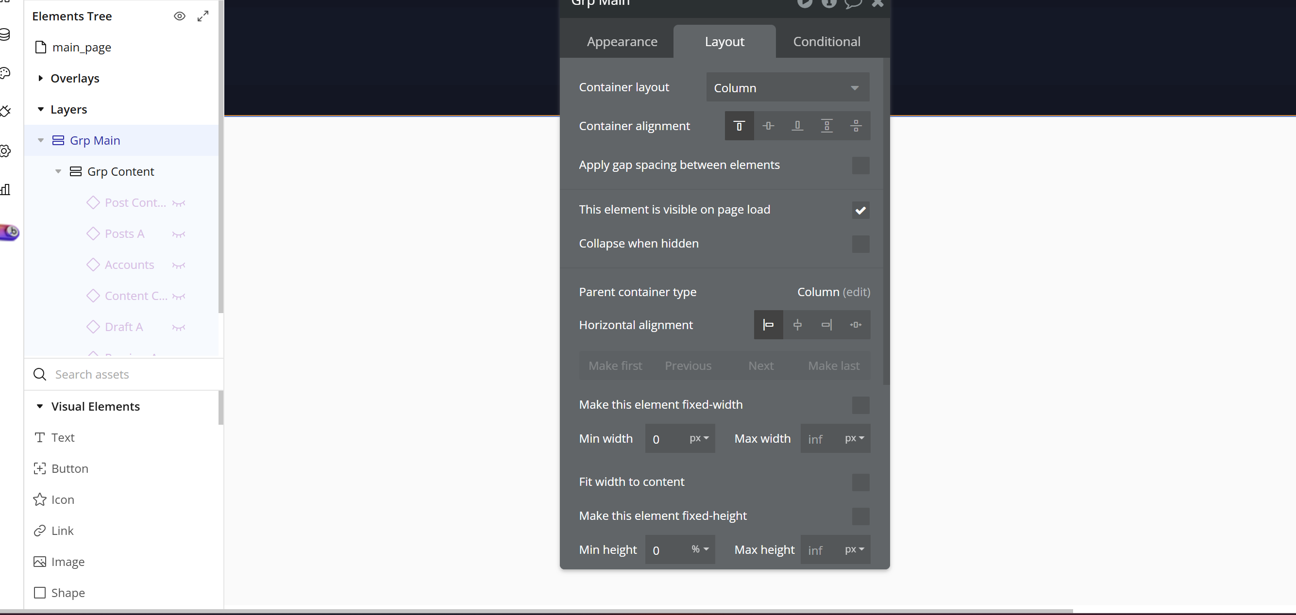

I am hoping someone can help me out with this. I do not know why the responsiveness is not there for the height.
On my monitor, the issue is not there since it is a bigger screen. On the laptop, there is a right space when the group goes past a certain height.
I went through all my groups and do not see the issue.
in the Grp Main deselect Fit height to content check box
probaly this solve
I believe I tried that. But I’ll try again and let you know.
Maybe you placed a color in another group and not in this one, put a color in the first group and you can leave the minimum height as 100%
I figured it out. The page itself had a background color of white. I needed to make it my black background.
Find the first group, the group who have everything inside, maybe this is the page, just change they color and minimum height as 100%
set the groups fit to height to vertical stretch so it matches the height of all the other columns in the row
