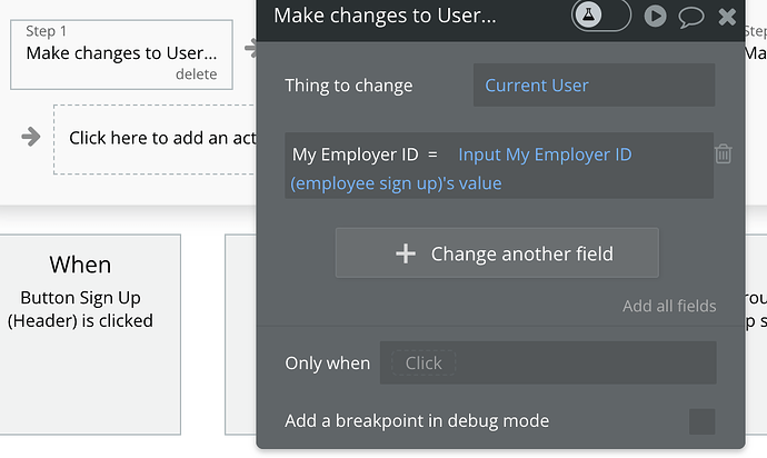

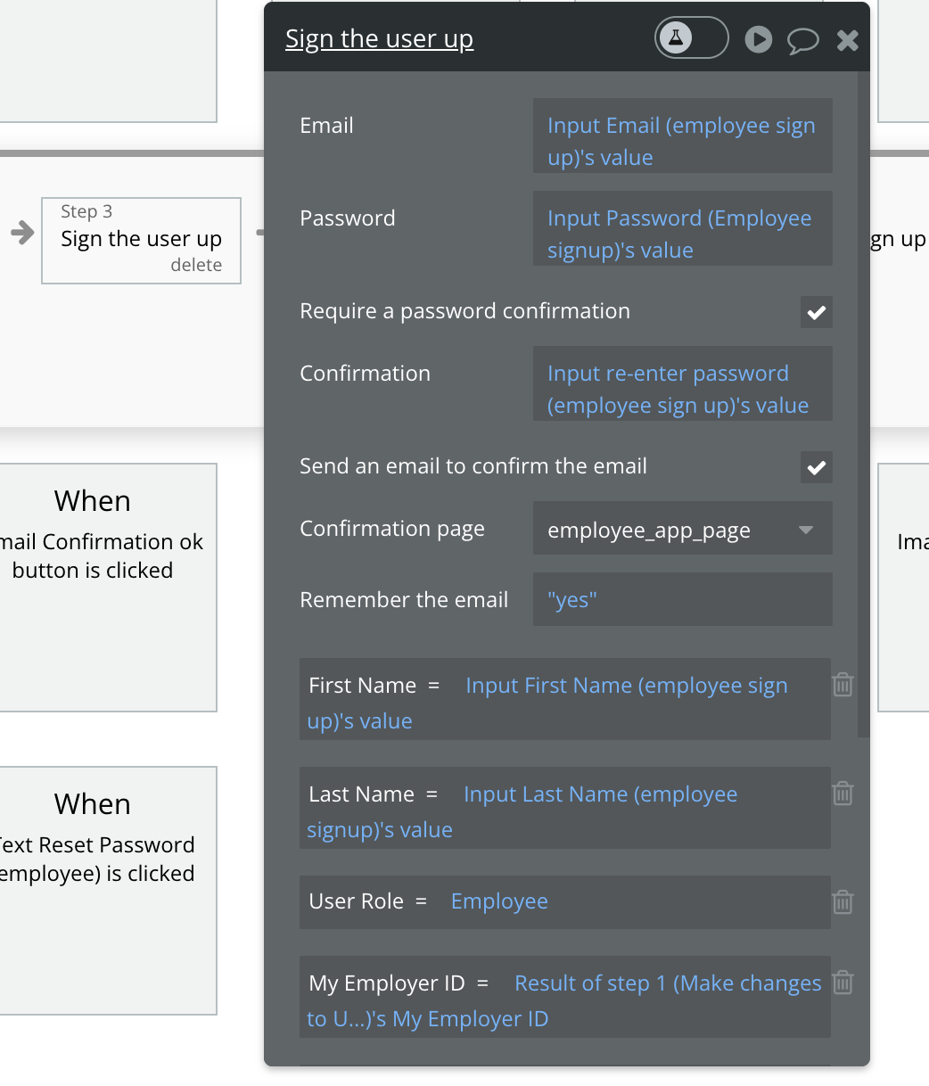

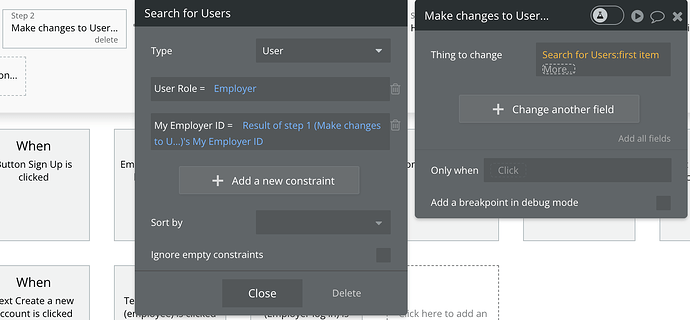

Why my search works just for the first search, retrieves no data after that
Privacy rules on the User data type.
Also, your Employer ID should probably an Employer (data type) rather than an ID (text).
Thank you George. I appreciate your quick response.
Question: Would privacy rules affect the second search but not the first one?
I will test on the data types.
Yes, because you’re searching for a User that isn’t the Current User.
Thank you George. It was a privacy rules issue. I was able to fix it with your advice.
