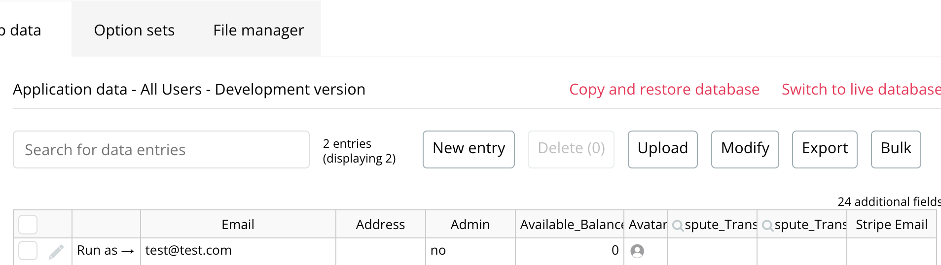

Couples victory lap screenshots.
^^^^^^The scammers in the ScammerDB as they try to sign up and fail
^^^^^^^The test user happily retaining full app privileges while scammers are turned away and not entered into the user database
