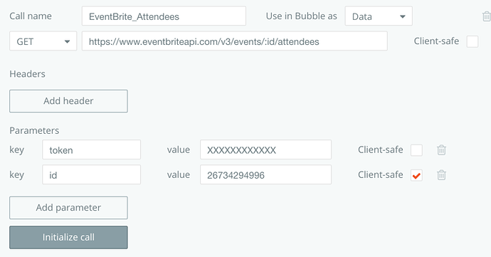

I’m using Postman to test the syntax to GET data from the EventBrite API. I am successfully getting a 200 code in Postman but the same syntax in BubbleAPI Connector gives me a 404 error. Why?
This is working in Postman
But, using that same syntax in BubbleAPI Connector generates a 404 error.
Any ideas why this works in Postman but not Bubble?

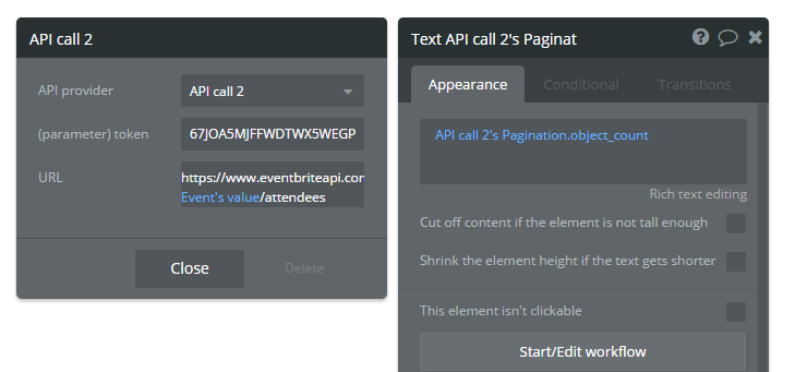

It should work, just put your id straight in:

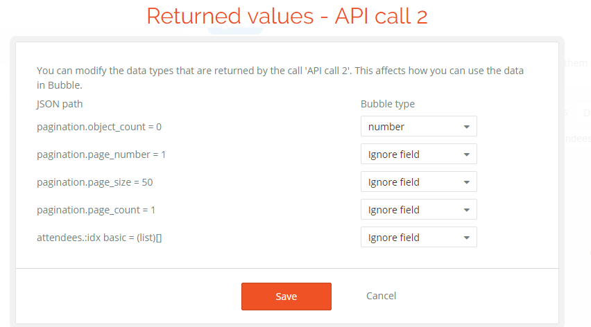

then you can initialize and set the data types:
then go back and change the event id to {id}
Then you can dynamically replace that part of the url:
it’s kind of tricky to replace just that section of the url:
I think the real problem that you may end up facing is the type of data returned from the api (ie the attendees is a list of attendee objects) how to handle that…
