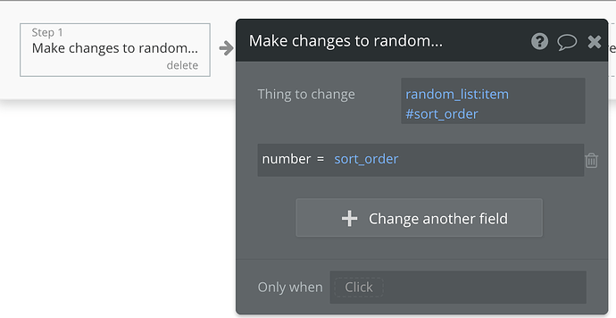

The first step in that endpoint is to do the actual update of the data thing. It uses the sort_order to choose which thing to update, and also for the number value (for you, your team’s performance):

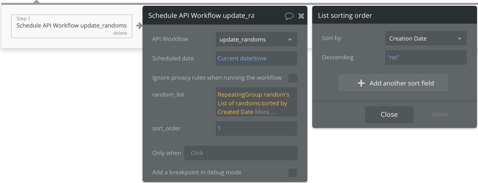

To kick off the api, use the action Schedule API Workflow (NOT Schedule API Workflow on a list) and just pass it a sorted list (I just used created date for example,) and start the counter at 1. I am showing the sort here in the workflow, but you could just pass the rg list if it has already been sorted:

Oh my, that’s elaborate! Thanks a lot for your reply.
It’s going to take me a while to wrap my head around it (API Workflows still kind of confuse me), but I’ll stumble through it and hopefully get this working thanks to your helpful reply!
Got it! Works perfectly, thanks a lot! I was initially confused about where exactly the workflows where being placed (either in API workflow or the page’s workflow, which is why I wasn’t seeing/confused about the “sort_order”).
