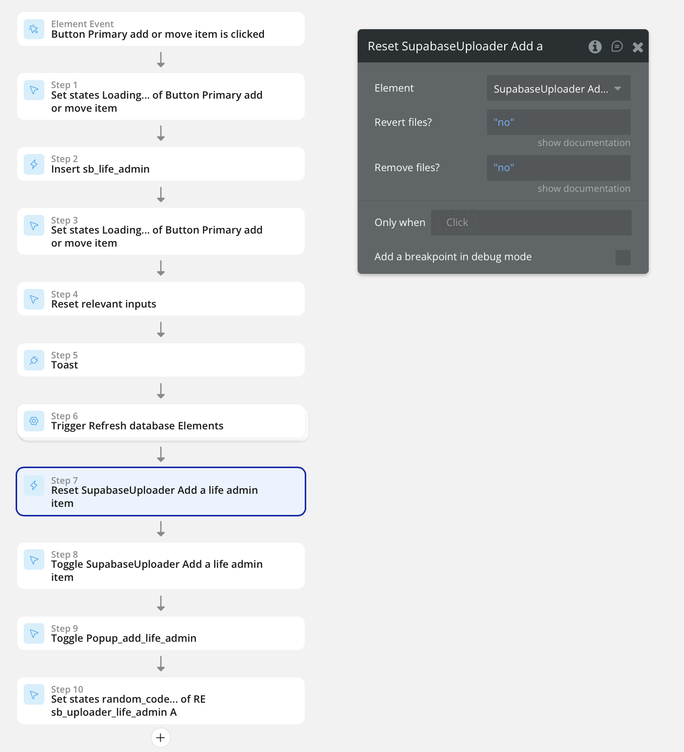

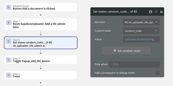

I have a use case where a user creates a record in our supabase table and at the same time creates a file in the storage in a folder that is the unique id. I have a process where I generate a random code for all the uploads and store the uploaded filename in the relevent users table.
my issue is that when a user wants to add an item, our process generates the random code and passes it into the plugin for it to create the file on the storage - this works. however when they want to upload another file for another record (only one file per record) in the same folder. our process regenerates a new random code, however the plugin has not recognised that the code has changed and tries to create the file in the storage with the previous name. I’ve tried to ‘reset’ the element, but I can’t seem to find a way to force it to forget the old code and replace with the new one.
hopefully you can see it in my screen shots. the code is in the bottom centre for the new entry (bpj….) and you can see on the diagnostic that the old file (EJq….) was processed and then attempted again.
my workflow has the reset element within it, as does the clearing of the code and resetting of a new code.

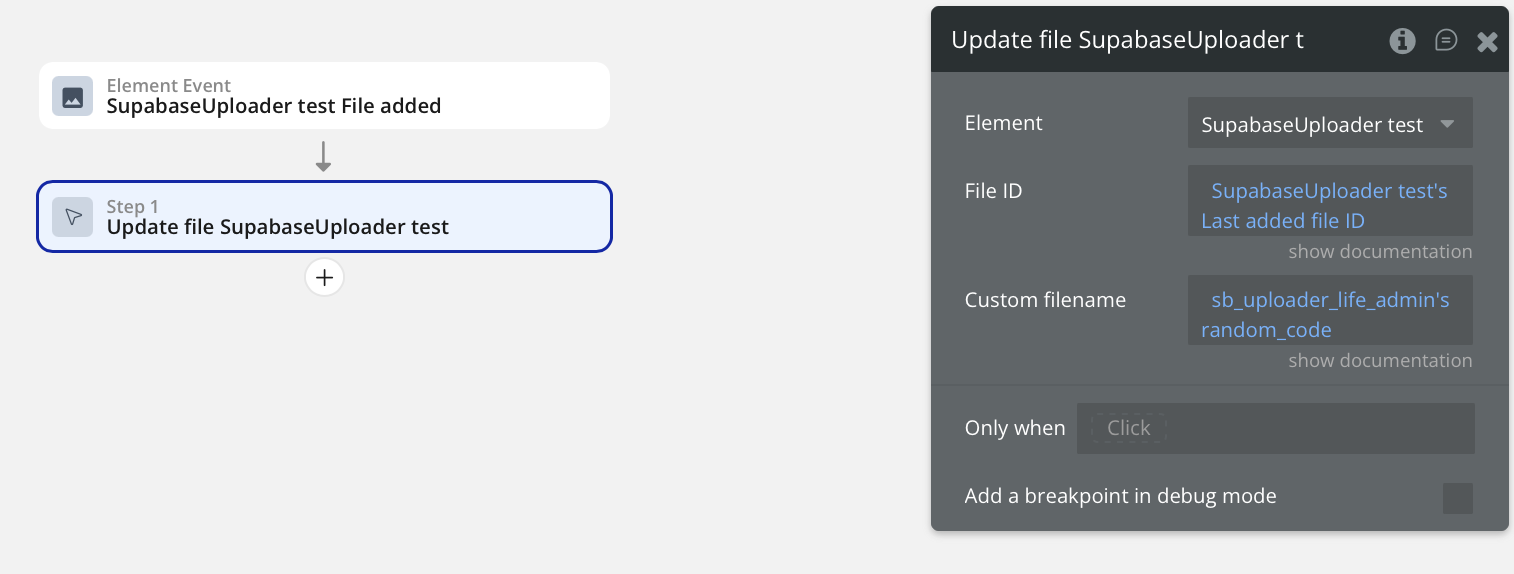

I have since found a workaround for this problem after many hours thinking about it…
I have a workflow that is triggered when a file is uploaded…
this renames the file to the unique reference I’ve pre generated and allows the file to be saved.
