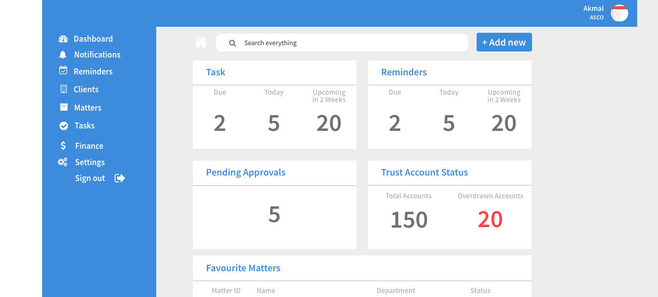

ive finished the documentation and learnt from a course that i brought from udermy. as for now i am trying to build a system to help legal firm manage their files.
this is what ive build so far with a working backend. just trying to figure out few things here and there to play around with logis to get around with a few things
Good that you’re making swift progress. Given the type of application you’re designing, I think a great area to explore next (if you haven’t already) is building out privacy roles (and general security measures) in Bubble. It’s an often overlooked part of the building process when users are getting started, but certainly one of the most essential.
