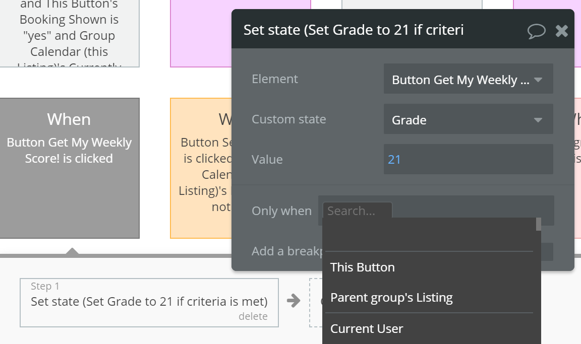

  1. Now your workflow components for mapping the other two grades are going to look like this. This step is created by selecting Element Actions > Set state:
Obviously, your workflow may have some preceding steps, but you get the idea. Set the variable Grade (which is stored on this Button) to 21 if (when) the criteria for this grade is true (“yes” in Bubble terms).
The second evaluation step is the one for grade “15” – set Grade to that value if the criteria for that Grade is met. NOW, it is not clear to me if the criteria for Grades “21” and “15” are mutually exclusive. Only you might know this.
If they are NOT mutually exclusive, we need a dual condition here. I’ve assumed that a weekly score that qualifies for grade “21” would ALSO qualify for a grade of “15”. (I think this is why you ordered your workflow steps the way you did, right?)
So, we will set the grade to “15” only when “It is NOT already 21” AND your other conditions for getting a score of “15”. Like this:
Now you will note that you DO NOT even need to bother with figuring out if the weekly score was enough for a grade of 12… This Button’s Grade will already be 12 (by default that we set in the Custom State) if it has not been changed by these two preceding workflow steps.
Neat, right?
