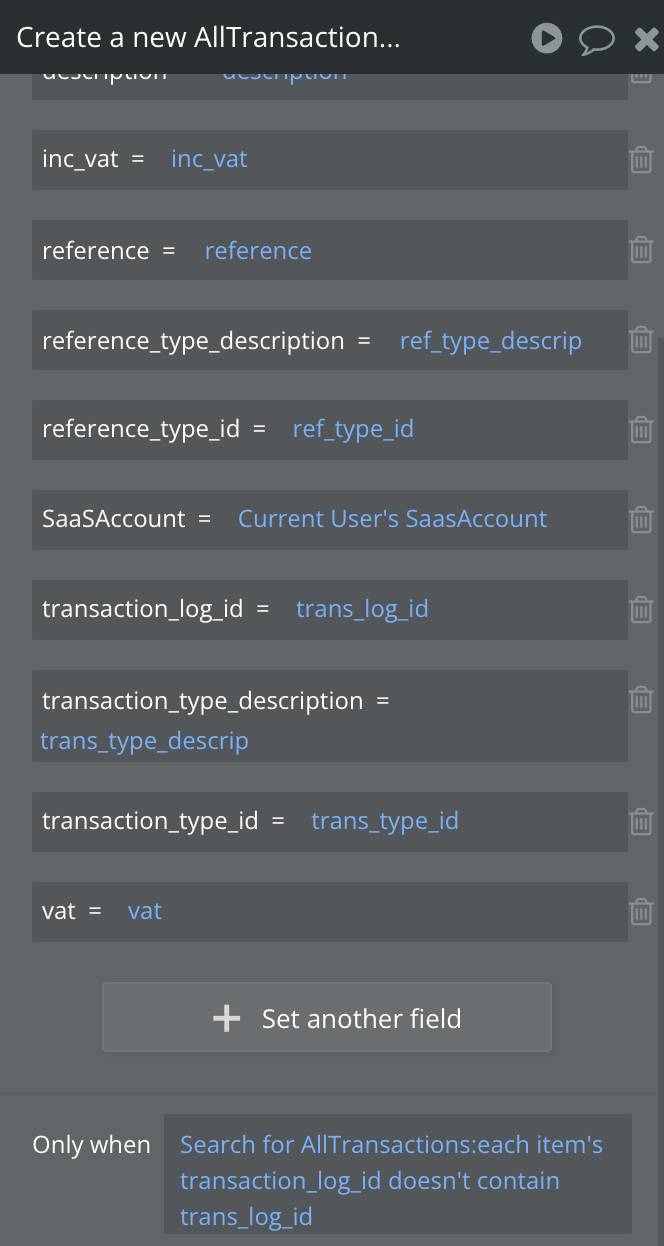

Yeah, I did check the logs, one of the workflows was using around 211 units per run
But it is so out of place, because I have another workflow (doing basically the same thing), which was not using even close to that amount of WU
I am now afraid to try turn them on again, lest I cost myself another $350 every 2 hours
Can you show us the actions in the workflow? 211 WUs is obscene
And how many AllTransactions do you have in your database?
After running this action on 3 users, I have 11 000 in total

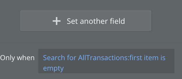

Is there a reason you haven’t used
Search for AllTransactions:first item is empty
Constraint:
transaction_log_id doesn’t contain trans_log_id
I dont have a specific reason, but I also dont know what the difference is between that and what I have done…
This constraint is basically just to make sure I dont land up with duplicate data in my DB…
Okay, well if you have 11,000 items, the last time that workflow ran:
It searched for 11,000 items
It returned 11,000 items from the database at 0.015 WU each = 165 WUs (because you said :each item) and the WUs for each character of data from the database.
This is like getting all of the transactions and checking through each one by hand to check the condition.
What you should have done is this:
That’s just 0.2 WUs for an aggregate query (and maybe 0.3 WU too for it being a search, I’m not too sure but the point is it’s tiny)
This is more like asking someone else (Bubble) to pass you all of the transactions that fulfil the condition, and you know if they give you no items that none of them fulfil that condition. Much quicker than checking all of them yourself.
Like this…??
Screenshot 2023-08-13 at 13.42.28
