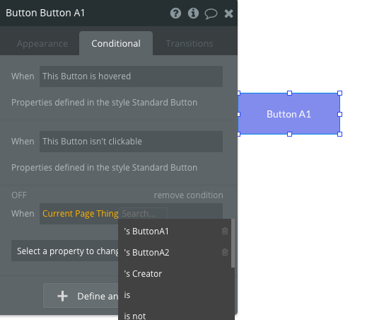

  3. Add a conditional for each Button A which will look at the Current Page Thing’s Button Ax to see if it’s “yes” and if so, make it invisible (Note - depending on what Data Type you put the Button Data Fields, you might have “Current User”).
    You actually may want to have all Button Ax invisible on page load and have a second condition for each Button Ax that if Buttons Ax is “no”, make the button visible. That way you’ll eliminate a quick “flash” of the Ax buttons being visible on page load when they should be hidden (ie their value is “yes”) (I added that to the image below)
  4. Add a conditional for each Button B simply put when the corresponding Button Ax is hidden (see image below)

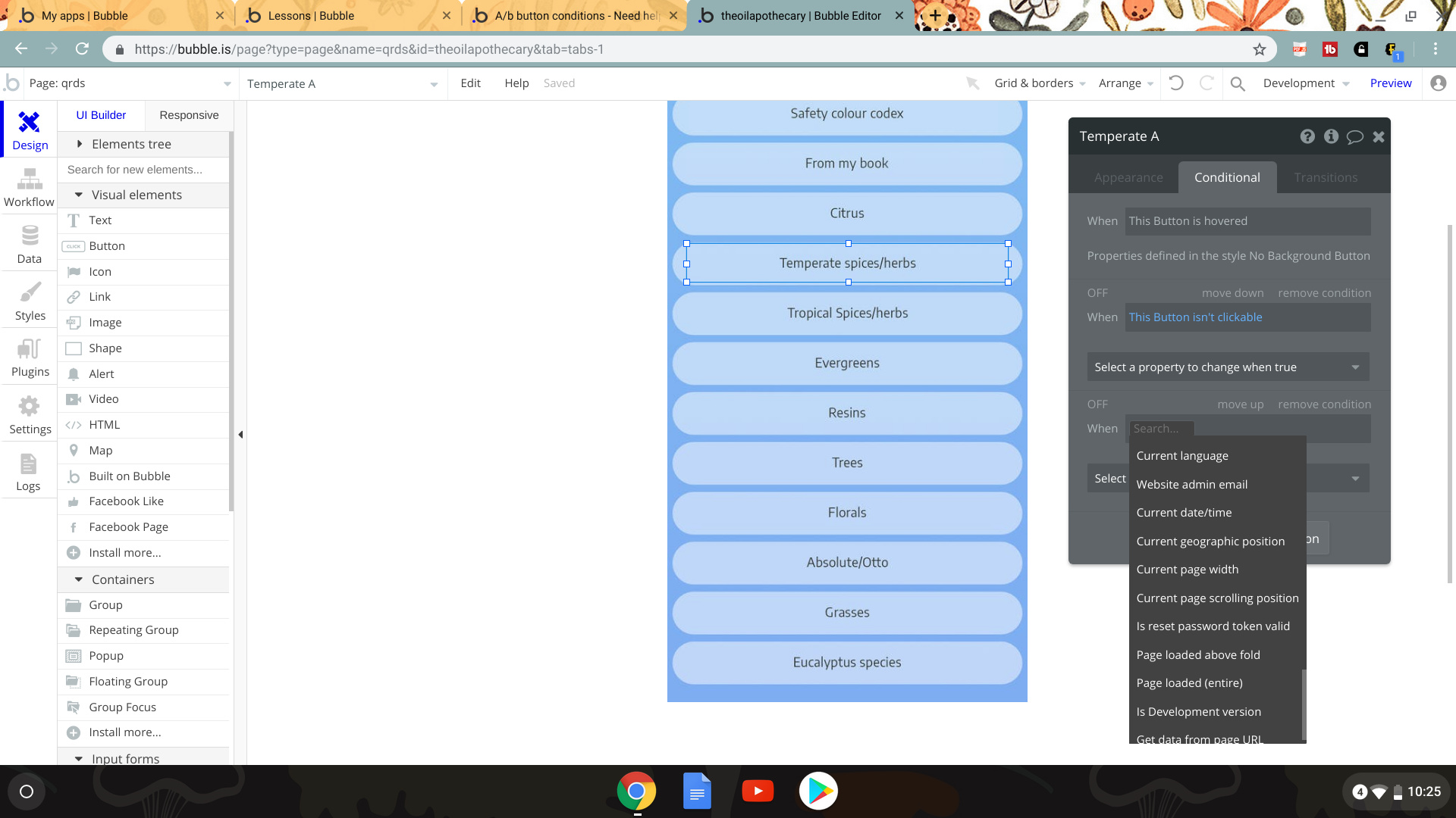

I’m trying to finish the conditions on my A buttons but I can’t find the “current page thing’s”

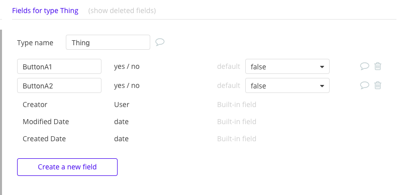

@porcheberry - what’s the Data Type for storing the “state” (yes/no or true/false) for each of the Buttons? In my example, my Data Type is “Thing”. Yours could be User, ApothecaryButton, etc. You need to set up your Data Type first. Then in the Data Type, you need to create a new Field, one for each Button.

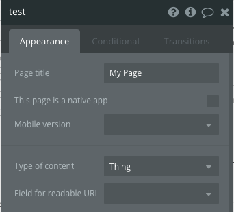

Also make sure the Type of Content for your page is setup as “Thing”
Then when you go to the Button’s Conditional, you’ll be able to make the selection
thank you. Question that probably has an obvious answer: Where am I looking to set the page type?
I cannot recall ever seeing it.
never mind I found it by accident lol

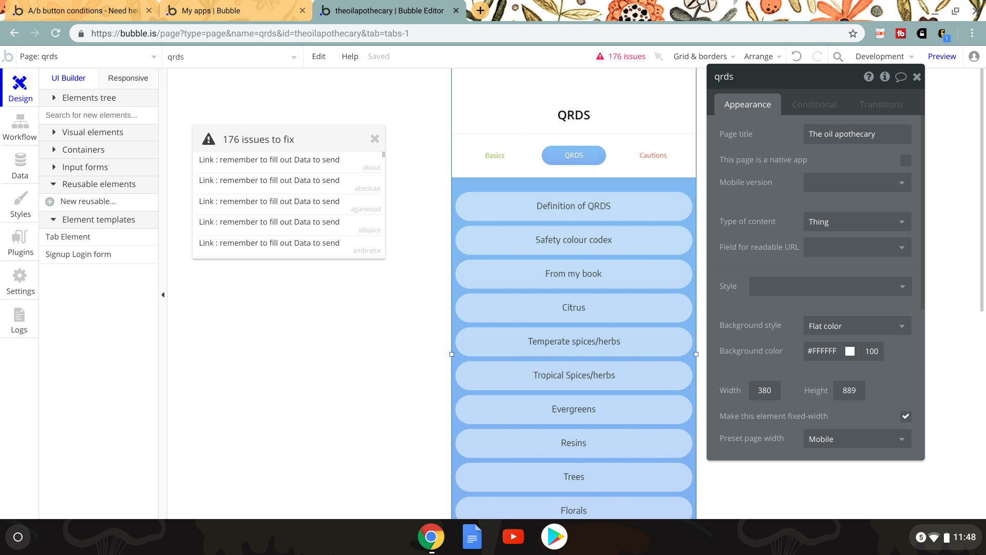

I don’t know what it wants with the new issues…
It looks like you’re trying to link to a page that expecting a data object, and your link isn’t sending any data. That’s my guess without seeing more details.
that sounds about right. I just don’t know how to fix it.

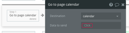

I’m assuming you’re clicking these buttons and the workflow is sending the user to another page in your app. Whatever page(s) those are have “Type of content” with a value (“Thing” in the example below)
In the workflow “Go to page” step, you’re probably seeing something like below for “Data to send”. You’ll need to select the right one, ie the data you’re sending in this step needs to match the data type of the page you’re going to.
