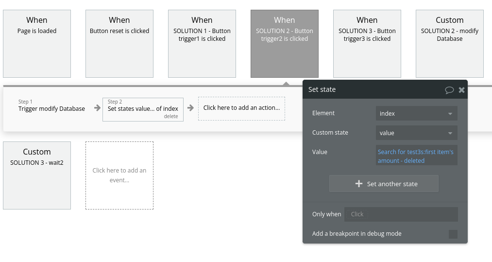

CASE: in a WF I want to modify a field in the database and, as a result, set a value to a custom state.
SOLUTION 1, the WRONG one (it’s here for explanation sake)
I click the button that triggers the WF, but step 2 is (or better: could be) faster than step 1 and no value is assigned to the custom state.
SOLUTION 2. The one suggested by @aschofer
Also this solution unfortunately is not consistent, sometimes step 2 is executed before the completion of step 1.
SOLUTION 3. The only one giving consistent results.
As you can see I activate a “ping-pong” loop…
ending when it’s sure that the value in the Database has been updated.

@gallahad11 I’ve just checked your app and I don’t understand what value you want to pass to custom state (as shown below)
What’s “amount - deleted” ? There is no corresponding field in a DB.
my fault, during this discussion I modified the app, deleted fields and unfortunately now is not working. I’ll do my best to correct this in the next minutes.
ok it’s at its original state. Sorry again for making you lose time.
