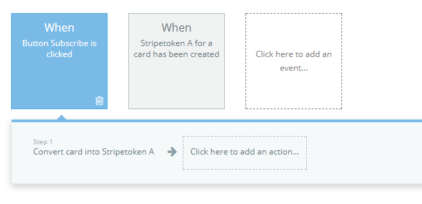

As of today, I started receiving a similar message with the stripe.js plugin by @copilot to “Convert card into Stripetoken A”. The specific error message is “StripetokenA Error: Expected a string, but got a number.” I confirmed that the inputs are in fact strings.
It appears that the subsequent stripe operation being initiated by the event “When Stripetoken A for a card has been created” (in my case I am adding a stripe customer) still goes through, but the bubble site hangs on this initial error described above.
Note: I am experiencing this error in"version-test".
@emmanuel Is this an error in the bubble code as it was in the post above, or could I be doing something wrong on my end?
@copilot please let me know if I am doing anything wrong here. I was following the instructions here: https://cobubble.com/stripejs?tab=documentation and this was working fine as of last night, but today I started getting this error.
