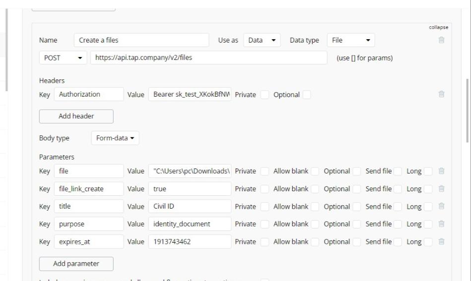

Hi
I set this call
And i got this response
Any idea how to fix it
Thank you

Try to set “Send file” checkbox for the file parameter

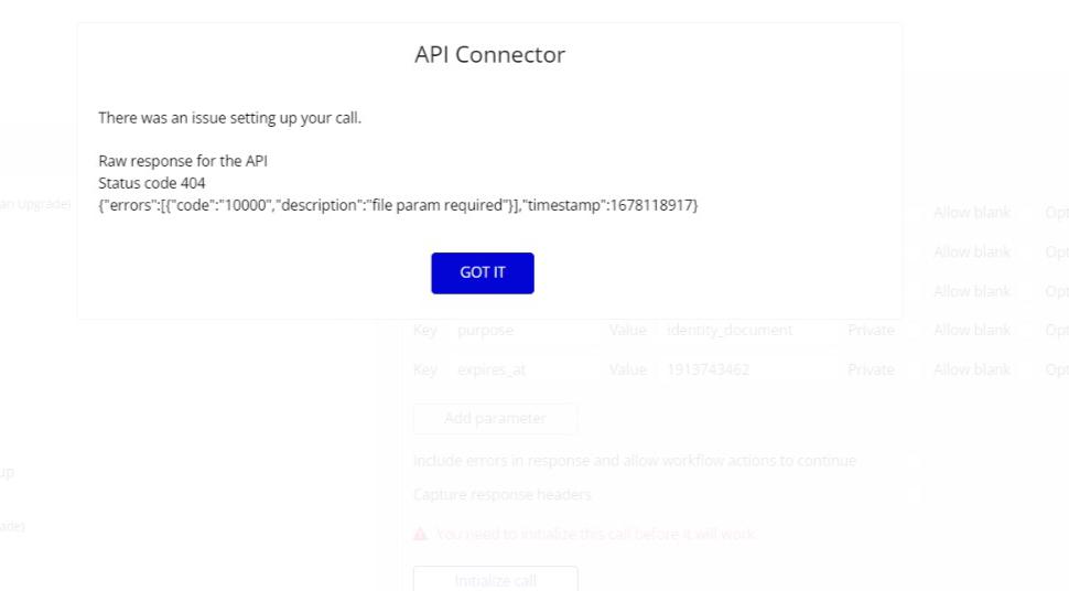

Sorry i posted the wrong picture
Here is the new error
You cannot enter a local file path like I told you. You can upload the file for testing.
can you give an example on non path file
url files (https…). When you click on send file, you also have an option to click and upload a file.
Hi
I did upload a file from the desktop then initialize the api
There was an issue setting up your call.
but i got this
There was an issue getting the file for the call undefined - API Call. See the response {“id”:“file_1082386978106109952”,“object”:“file”,“live_mode”:false,“api_version”:“1.0”,“feature_version”:“1.0”,“created”:1678131565,“filename”:“cb4ae8324b54e6acd113a559762741bf.jpeg”,“purpose”:“identity_document”,“size”:1290,“title”:“Civil ID”,“type”:“jpeg”,“url”:"/api/v1/files/file_1082386978106109952",“links”:[{“id”:“link_1082386979104354304”,“object”:“file_link”,“live_mode”:true,“api_version”:“1.0”,“feature_version”:“1.0”,“created”:1678131565,“expired”:false,“expires_at”:1913743462,“url”:"/api/v1/links/fl_test_1082386979104354305"}]}

Hi
The api is working now , the problem was with the api keys
Thank you for the support
