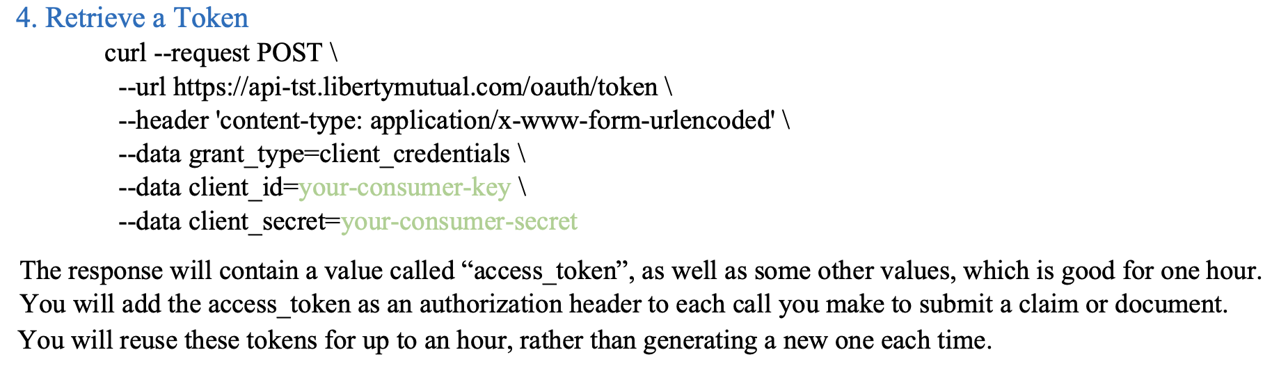

I have an API call to request an auth token, the call works fine in postman but I continue to get a 401 error in bubble. I’ve seem to try all possible solutions and am just stuck at this point.

Hey, make sure you are using correct content-type and add link to the api docs if you will need any additional help.
Im using the content type required by the “docs” and I use quotes because they don’t have proper documentation for token access. Only a pdf with a curl method. See below
have you actually supplied the client identifier or are you trying to initialize blank?
grant_type=client_credentials&client_id=<client_id>&client_secret=<client_secret>
Got it! I had the keys in there yes but had forgotten you said to remove the brackets.
So after removing the brackets it worked. Thank you!
