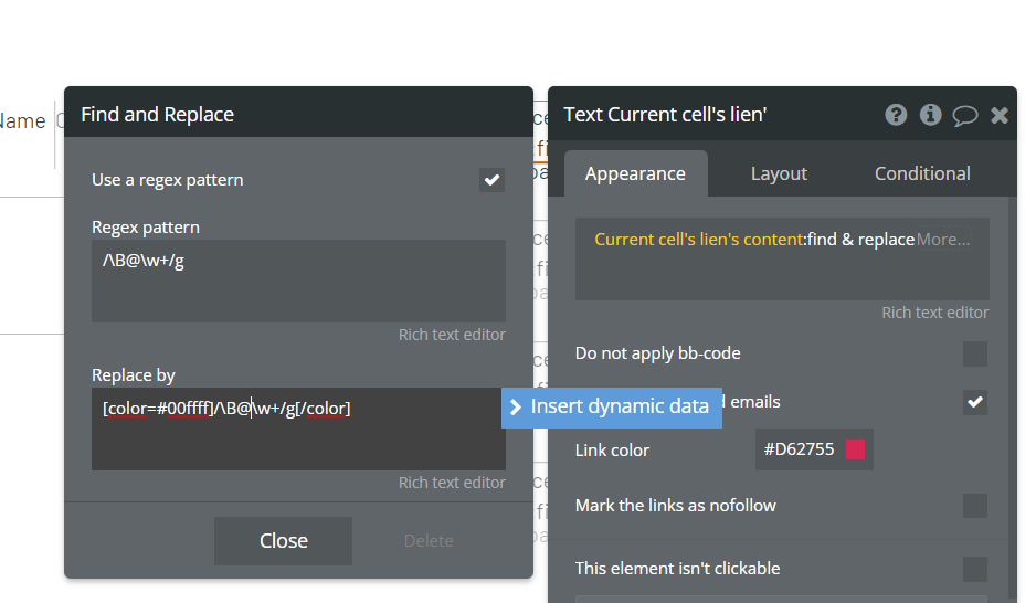

Sorry to be annoying :sweat_smile:. I tried to use the regex @j805 sent, like shown under, but it doesn’t work, am I using it right?
Maybe try this one instead. Not as complex but might work with the way Bubble handles things. @\S+
This works! I have one last question, how I keep the same text, because now I have these results:

@fbnc.vntrs Here is an example to show you what I mean.
Hope that helps! :blush:
