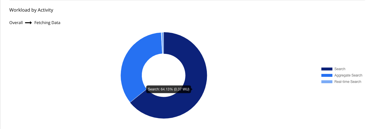

Then when I click into the Fetching Data I see 3 different types of Searches
- Search
- Aggregate Search
- Real Time Search
When I click into each, I see that each one is attributed to the same search (the only search performed on the page which was loaded ONCE)

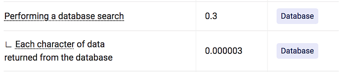

Based on the WU activity pricing in the manual I am assuming that Search is two components
Which makes sense as a total value of 0.37 WUs reported, which could be the 0.3 + (X number of characters *0.000003).

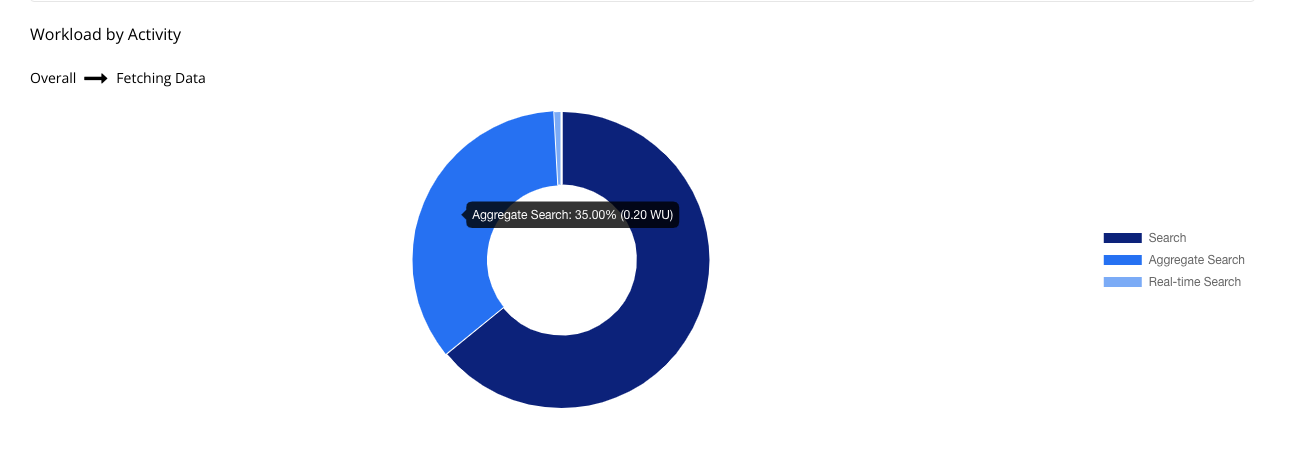

Then should I assume that the Aggregate search of 0.20 WUs is ‘Performing an Aggregate Query in the database’? And why would that not have just been the ‘Performing a database search’?
And, what is an Aggregate Query in the database? Is that supposed to be a simple “Do a Search”? Something like below, which is what I am testing.
