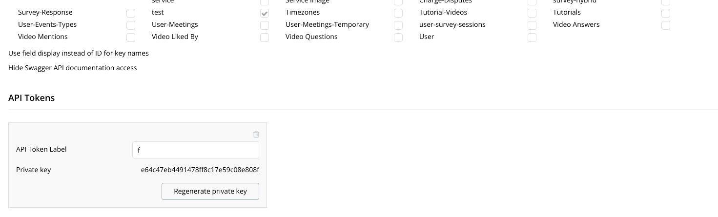

API Tokens
But I have noticed that anyone can call my data API endpoint, Even without an authorization header.

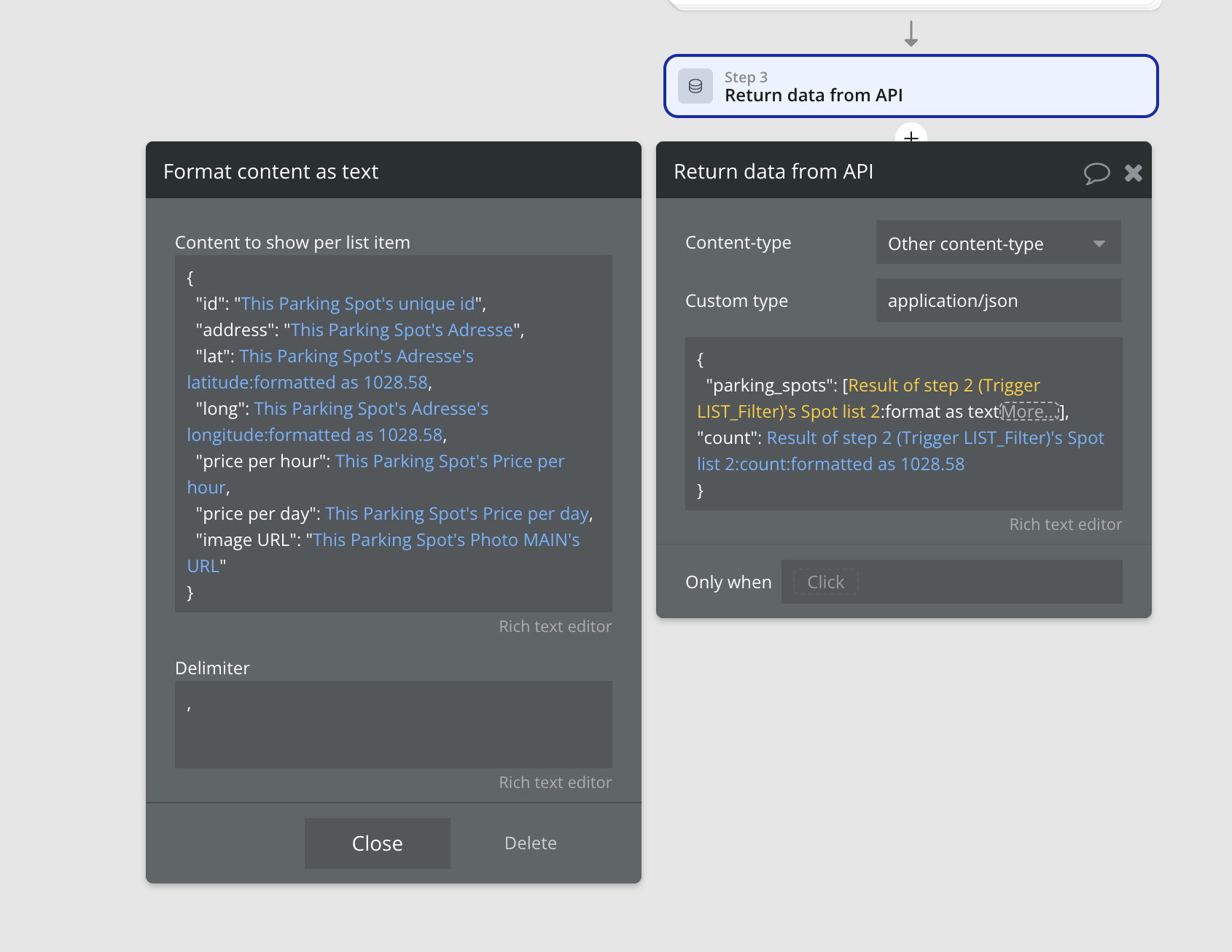

@thibautranger can’t you use return data from a backend workflow, but instead of returning the actual Bubble things, return JSON and format the things appropriately? I’d be surprised if there’s a limit there…

I am currently doing this, returning data from API and setting content-type as structured JSON.
With this setup, list is limited to 50.
Set the content-type to custom and use application/json

Okay, so the Admin API Token is needed in the Authorization Header I believe based on my testing and what I am seeing, but I may just not understand the security aspect very well.
If I have an API call set to take data from my apps database, in the settings I have each data type in my database available to be checked on or off basically, so as to make them accessible or not. When I try to initialize the API call with the data type unchecked, so as to not be available, whether or not I send in an Authorization Header with a Admin API token, I get the following error from Bubble.
But if I do check the box for that data type, so as to make it accessible, and I try to initialize my api call without an authorization header present, I get the following successful initialization.
But if I do check the box for that data type, so as to make it accessible, and I try to initialize my api call with an authorization header present, but not a valid Admin API Token, I get the following error message from Bubble.
In both situations above with the data type api endpoint enabled, I did not have Privacy Rules on the data type. So once I add Privacy Rules that allow if the User Type is Admin to find in searches but everybody else can not, then I get the following.

  1. Backend workflow is called
  2. I am using a custom event to generate my list of things, then returning the list as a return value
  3. I am using “Return data from API”, setting the content-type as “application/json”, and I format my JSON manually.
Indeed, there doesn’t seem to be a limit with that. I just tried with random test data with 15’000 lines of JSON and it works well.
