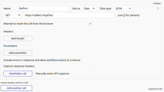

My API connector is set like so:
What I was expecting was to do an API call on each single row of the RG and so I should see several different texts on my page.

Bubble sees you’re making an API call. It sees there’s no input parameters, so assumes the output would always be the same. Hence, it only makes the call once. Why would it run it multiple times when it knows what the output is?
However, you’re clearly working with a random response API, which is unusual. To display the random responses in a RG, you need to get a list of facts from the API, probably from a different endpoint. Your use case probably isn’t possible (straightforwardly) simply because it’s inefficient design to make an API call for each cell, when you can make one API call for multiple cells.

@georgecollier is totally true and yes this done to optimize performance. A single tips is to add a header (name it like you want) and use Current cell’s index into this header. This will force Bubble to call the API for each cell.
Yes, that works, thanks :slight_smile:
