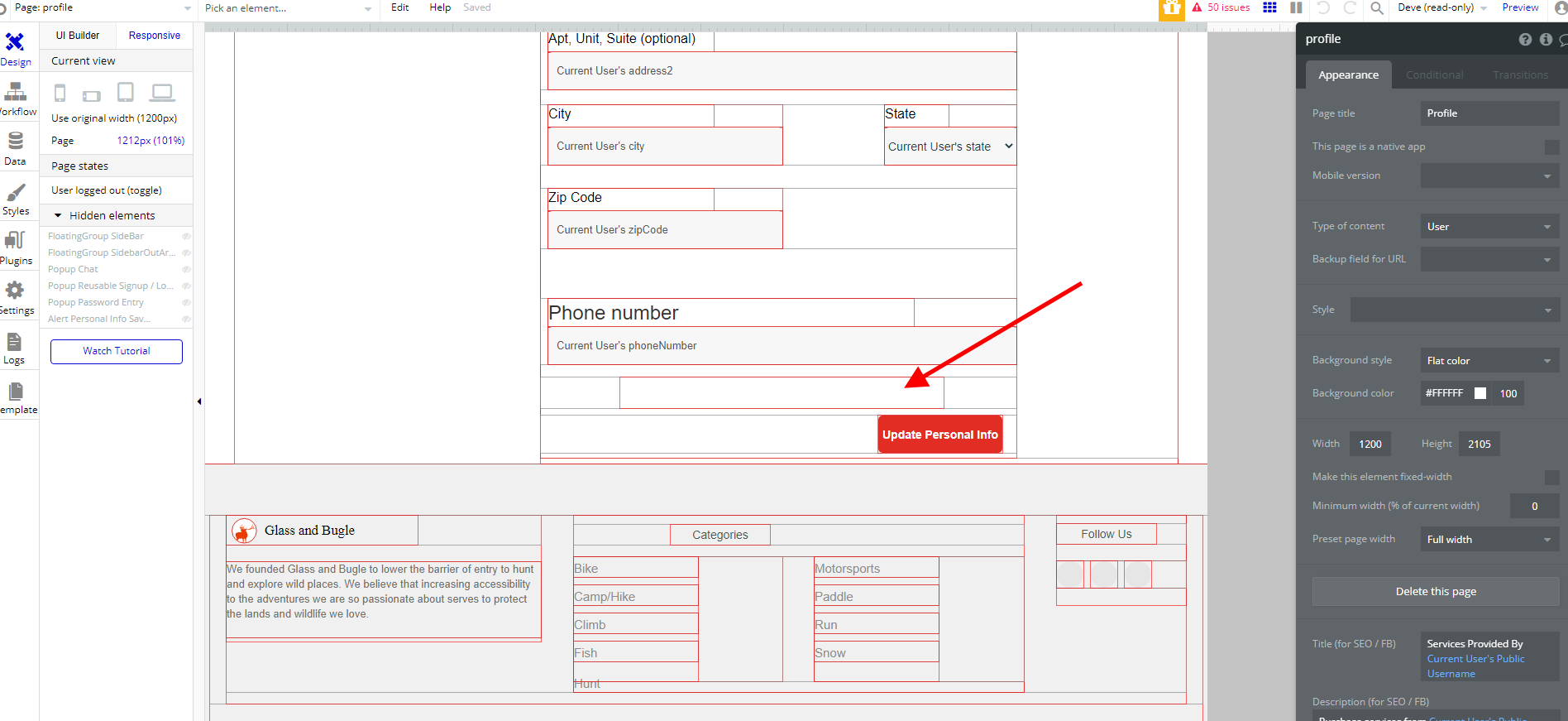

Finally stumbled into the phantom button.
While adding a new feature to the page, I went into the responsive viewer and noticed another phantom element. The new anomaly was a text element.
I selected the text object and clicked edit in the responsive element inspector. This brought me into the UI editor. The element remained hidden, but the element inspector was visible and I deleted the text object. Repeated the process for the phantom button.
Still stumped on the issues origin, but we learned the responsive view is valuable when looking for ghosts.
