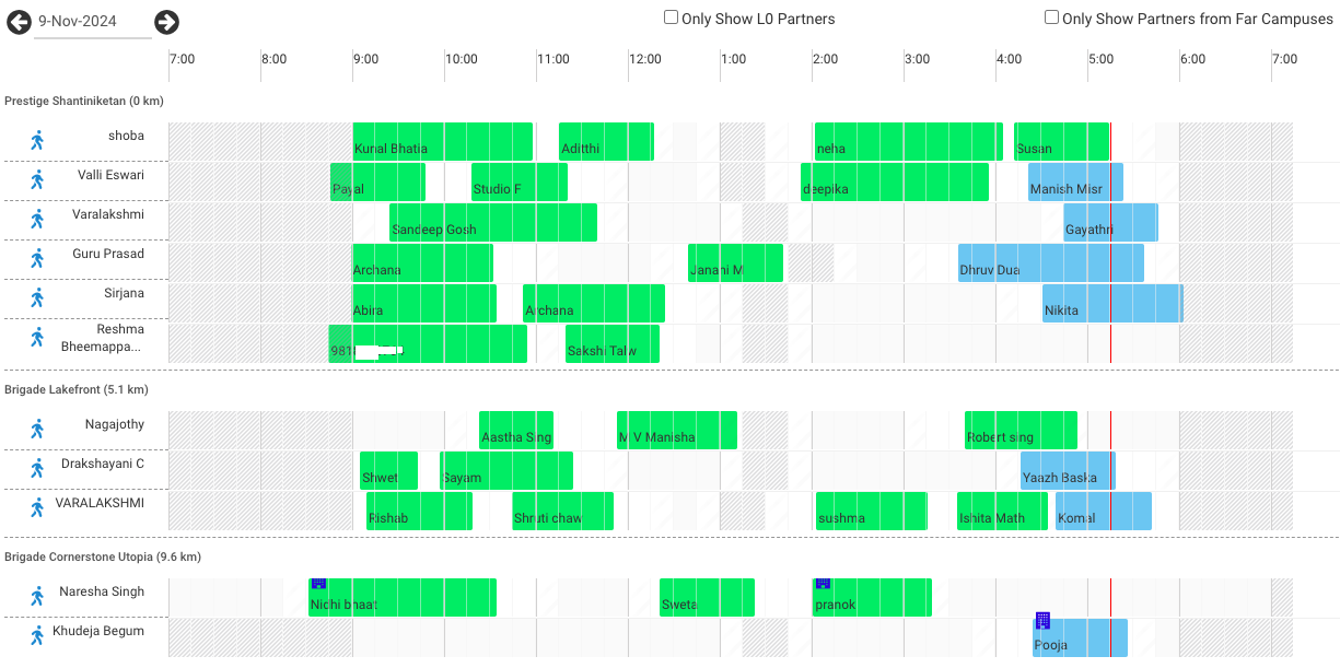

My question is this. There is an online education platform called Preply.com where they can choose lessons from the teacher they want to show and make an online program. I will show a few sections from this page in the picture below.
There is a calendar that appears in the management panel of the sections below and you need to click on the calendars in this calendar to assign the sections to the hour and make togetherness lessons. Of course, you can only do this if they have taken lessons from you before.
In short, can a calendar be created visually and functionally like in the picture with Bubble io?

For the thing that you are looking for I think there are some plugins and templates out there. Something like “Full Calendar Suite” or some such names are there.
In my use-case what these plugins do was not sufficient.

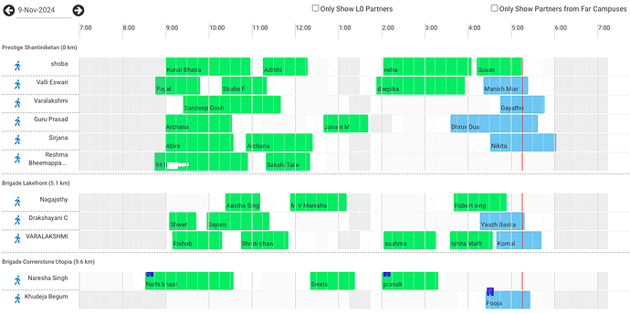

Here’s how my screen looks like which was for my use-case (i.e. In rows I wanted resource names, in column I wanted hours in the day. I wanted calendar just for a day. I also wanted ability to put some labels and colour codes depending on some conditions and other such functionalities).
I managed to achieve it via native Bubble functionalities, but with lot of hacks and somewhat unoptimised code. Also there are some compromises on how it looks visually. It was a lot of work though for me. Not easy to share any quick guide.
