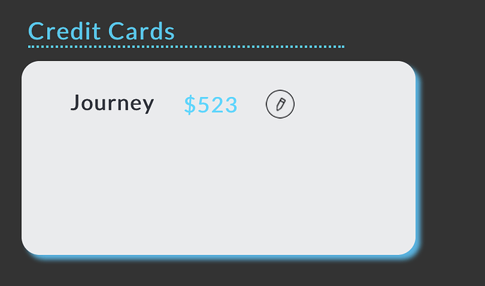

I am trying to make a simple budget application for personal use, nothing extreme. The page has a label, input box, and 3 buttons.

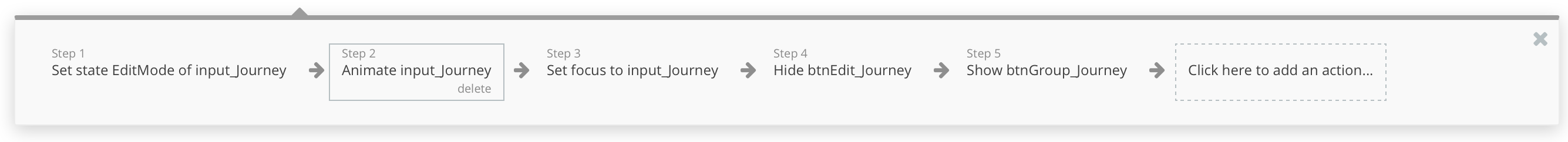

Edit button:
  1. Sets the input box custom state “Editmode” to “yes” (This enables the input box, changes the background color and adds a border)
  2. Animates the input box
  3. Sets focus to input box
  4. Hides the edit button
  5. Shows the Save and Cancel button group

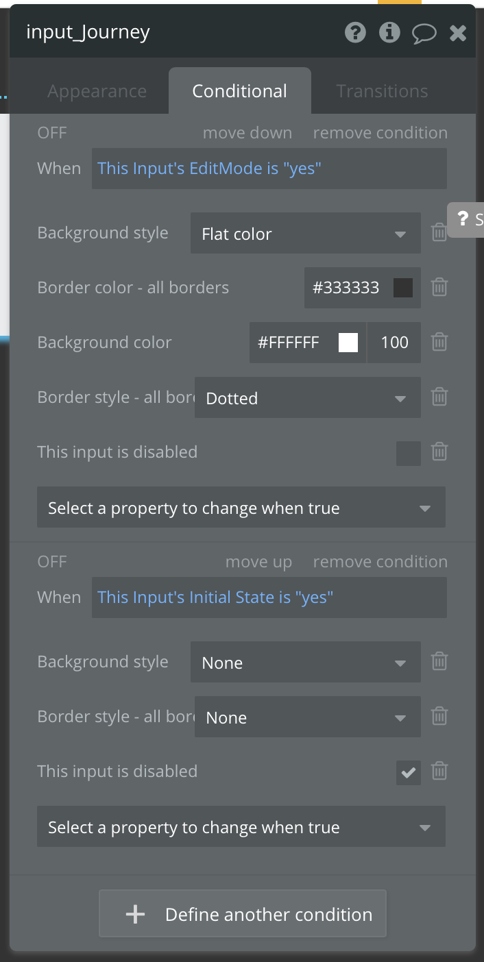

Picture of input box Conditional :
When I press the edit button, everything works fine both save and cancel. But after I save or cancel, when I press the edit button again Step 1does not work, thus not enabling the input box.
Initial Startup:
Edit button is pressed:
Cancel is pressed, then edit again:
As you can see the edit button will hide itself and show the save and cancel buttons but does not activate the input box.

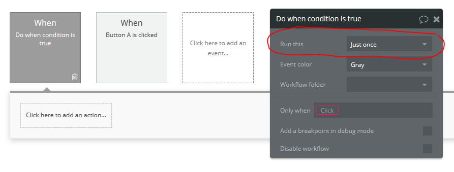

Also, don’t forget you can choose in a workflow to run “Only Once” or “Every Time”. I have forgotten to select that before and had the same problem. :blush: Hope that helps! :slight_smile:
Check the top workflow. You probably have, when this state is true do this “only one”.
Thanks for the response, I ran the application in debug mode. It shows the same values as it does when the function works. The only way for the workflow to work properly again is if I reload the page.
Hi, I do not see an option showing where to only run a workflow once.
There’s an option to run one at a time. I think that’s what he’s referring to.

This is what I was talking about :slight_smile:
I figured it out! I was using two different States to define what the input box should do. When I used the same State for both actions and set one of the buttons to negate the state, I was able to switch between the states without having to refresh.
