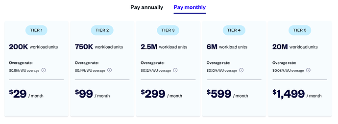

Preciso estimar esse custo da plataforma para que o cliente saiba quanto vai pagar. Entre o plano Start $32 e o plano Growth $134, são 100 dólares de diferença praticamente.
If you don’t need the additional features offered in Growth plan, you can instead stay on the Starter plan, but ‘add’ WU in tiers. For example, you can add 200K WU to the Starter plan for only an additional $29 / month for Tier 1, which gives you a total of 375K for a total of $61/month:
For the purposes of your estimated WU consumption, I would estimate that each ‘line’ you’re adding to a quote will cost around 1WU, the quote itself will be around 1.5WU, so depending on the size of the quote, 5-6 lines might cost you 10-12 WU, 20-25 at the highest (if you’re doing a lot on the backend). Based on your description, I don’t expect you’d use more than 175K. But if you did…again you can more than double that for only $29.
