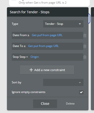

I have been working on getting this search functionality done all day today and I finally got it working but it is eating up workflow and is pretty slow.
Search: Enter Inputs press a button, load page with URL params.
On Page Load:
Images above walk through step by step, this solution takes about a second to load 2 results on first page load, this search is going to be used to display thousands of records, so if 2 take a second, I would hate to see 1000.
Please let me know of anyways to optimize this without transferring my entire database to supabase (heavily considering it)

Here is a look at our database:
I have been working for a while on reworking to add new features but its obviously added more complexity to the search.
Tender holds access to Stops and Financial
Stop holds access to Facility’s Commodities, additional number and requirements.
If you have any tips on I can further optimize, it would be greatly appreciated.

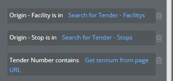

I updated my database to hold Origin & Destination, Stop & Facility directly in the Tender itself. then I can do one search directly in the tender. However, I still have to do a search for matches within the constraint, See below images.
Database Additions:
Workflow Changes:
Solved/Moving on
I transitioned to holding the first stops data directly in the Tender itself, this elements all extra search’s
I am not a fan of having data repeated but this is the solution I am going with for now.
