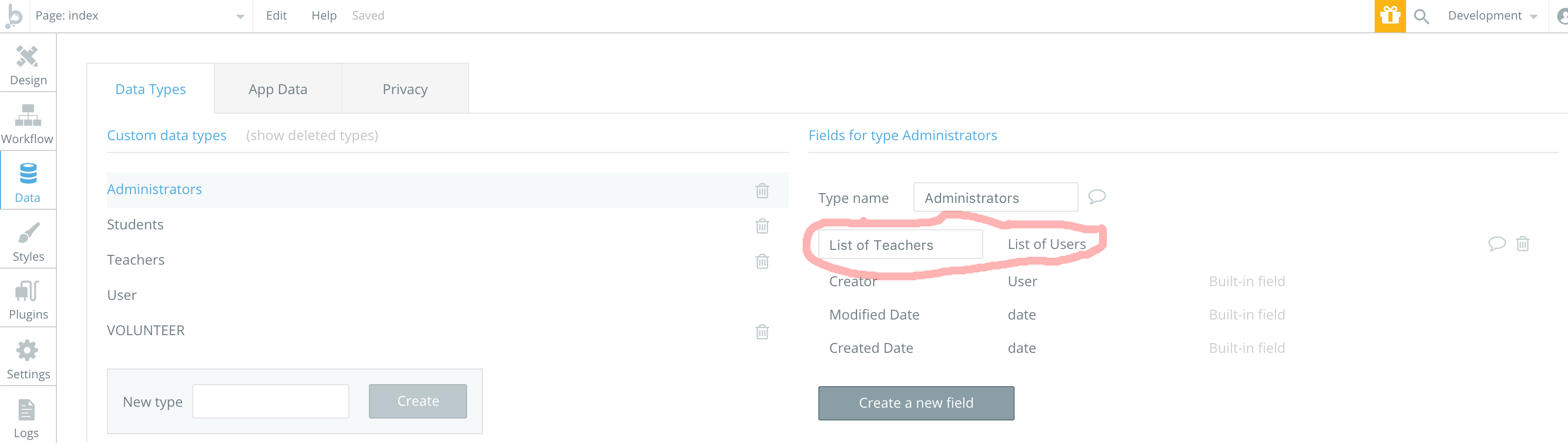

@romanmg , thanks for the response. It looks like you are suggesting creating different Things for each role, is this correct? Why not just have a thing called Roles and inside of that Thing have RolenameX, ListofRolenameXUsers, RolenameY, ListofRolenameYUsers, etc? Like this:
Whereby Administrators, Students, and Teachers just have a single entry with “administrator”, “student”, and “teacher” respectively.

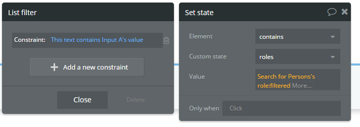

  1. Have a separate table with roles on, then you can do a partial search on the TEXT field, and then use that list to search the User.
  2. Create a temporary custom state, which is a list of texts with partial match, then use that to filter the Users.

I just read @NigelG’s response where (I think) he’s saying your way is simpler, but I’m seeing some areas where it might require more steps to search. For example, to simply identify the user’s role. For the solution of multiple lists in a single record, you’d have to check each list (yes or no value)
This structure doesn’t allow you to retrieve the actual name of the role no matter how you spin it because the name is in the field label only.
