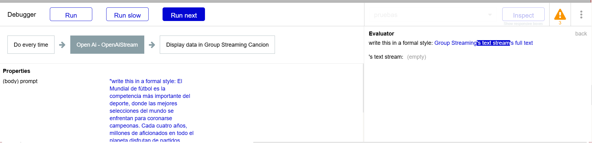

Hello! thanks! it worked but know when i want to do another text stream with the information of the previous one i have this problem
The text appears ath the debugger in the left but in reality as you see in the right the text stream is empty and i cannot use tthe answer

From what’s happening there, I’d recommend storing the text stream in a group and pulling the data from there, rather than using the ‘Every time’ action, as its behavior can be somewhat inconsistent.

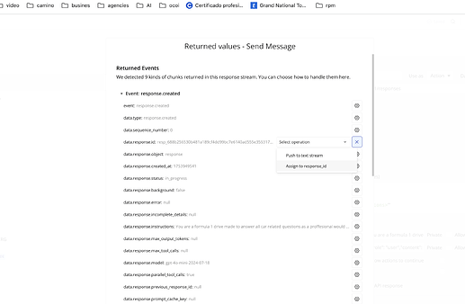

I would recommend one of the following approaches
a. Save the text stream full text to a database object (Create/Make changes to a Thing)… and pull the data from there.
b. Use the response ID from the previous call and include it in your next request. You will first need to set this up in the API Connector. I’ll leave the images below.
