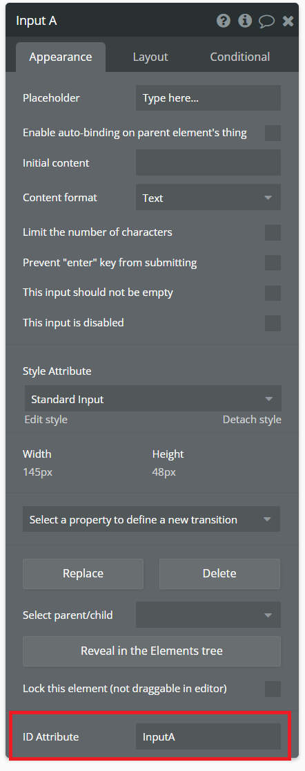

I just did a quick test of that plugin, and it seems to work like a charm. First, give your input element an ID attribute. The attribute can be anything you want.
If you don’t see that field, go to your Settings >> General tab and check the box that says Expose the option to add an ID attribute to HTML elements.

Oh man that’s fantastic!!! Thank you!! I was so nearly there but my inner moron had silently stepped up and mispelled the name of one of the IDAttributes! You’re right. It’s working pretty well though now. The only weeny niggle is that the cursor doesn’t change to a hand now when the button becomes clickable but I’m not too fussed about that.
