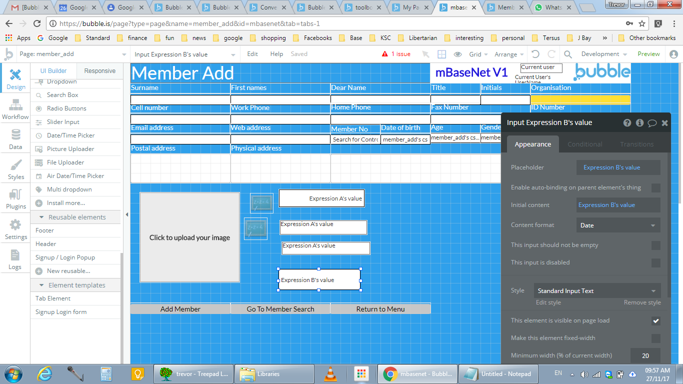

Can you show the properties of the input box?
Note, the placeholder text is only shown when the box is empty, and doesn’t contribute to the value entered. So usually it is used to prompt the user with a suggested format.
The initial content sets the value of the input box, but only if the user hasn’t changed it … although you can use the workflow actions reset inputs or clear group to get the input box to throw away the user’s changes and resume using the initial content.

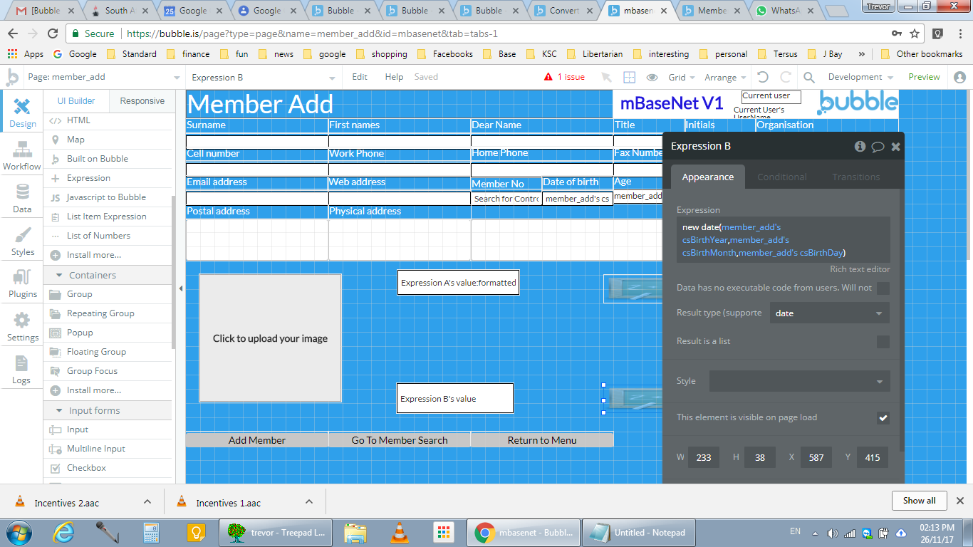

Error message received.
Input box for date
Expression to evaluate date
Javascript is case sensitive, new date(...) has a different meaning to new Date(...) . It is very particular about what you put in, which is what syntax error means.
I recommend you confirm what you want to happen …
