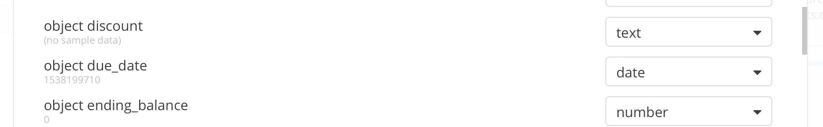

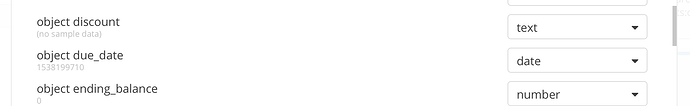

I have set that field type to be “date” when detecting the request data.
However when the workflow is triggered the date value is not being stored.
I assumed it’s because it’s trying to write “1538199710” into the field and it doesn’t recognise it.

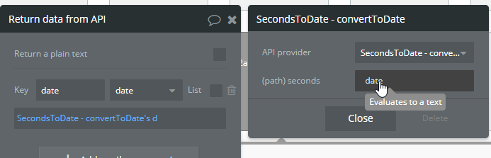

Anyway I managed to find a plugin (secondsToDate) to do the conversion.

Another workaround which is handy if using API workflows: a plugin that sends the seconds to MathJS API and returns the result as date form.

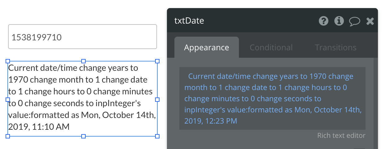

Perhaps I’m misunderstanding, but is there any reason one couldn’t simply initialize a date to 1/1/1970 and then “change seconds to”?
For example, the following seems to work for me…
Here’s the result (using the value from the image in @vagung’s post) …
44%20PM
…which is exactly what I get when the same value is entered into the following site…
