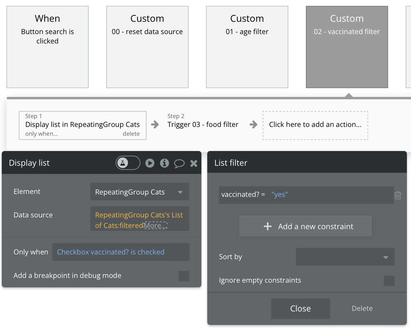

Sure. There are 4 custom events (CEs):
00 - reset data source
01 - age filter
02 - vaccinated filter
03 - food filter

That’s exactly how I’ve organised my test example above. With a small difference - default (unfiltered) data loaded on page load. Now I’ve changed this behaviour and no data is fetched until search button is clicked. Still no difference in number of requests, items fetched and WU consumed.
Not wanna take the role of DCF advocate (I don’t use it in my apps) but I suppose there are some scenarios when it is more comfortable way of managing filter options within an app (if there is no difference in performance and WU consumption).
For example, if you are using default checkbox elements a lot. Using DCF all you need is just to have a separate filtering custom event for each checkbox. If you are using “on-the-fly” filtering (apply filter at once without need to click on filter or search button) - you’ll need to create additional WFs for each checkbox to trigger DCF. But after WU model has been launched I’m not sure that “on-the-fly” filtering is a good idea :slight_smile:
Going with standard way filtering - you’ll have to manage a lot of conditional data sources.
Of course, there is an option with creating custom checkboxes (icons + text) and using custom states, but it requires additional job too (creating custom states + setting custom states in WFs). And if you have a lot of custom checkboxes - you’ll have a lot of custom states. And managing a huge list of custom states via small element inspector window is, to put it mildly, also not very convenient.
Another example - when you need to use advanced filtering to filter one data type using another data type. For example, filter blog posts based on multiple tags selected from a multidropdown. So with standard approach we need default data source + conditional data source for cases when at least 1 tag is selected in the multidropdown (cause if we will use advanced filtering in default data source - we will face client-side filtering even when multidropdown is empty). If we add/delete new constraints to/from default data source - we need not to forget to adopt conditional data source. Also “ignore empty constraints” is ignored by advanced filtering, so we need to add some excessive expression like ...or this multidropdown's value:count > 0.
And again - using DCF method will result in adding just one custom event to the WF.
