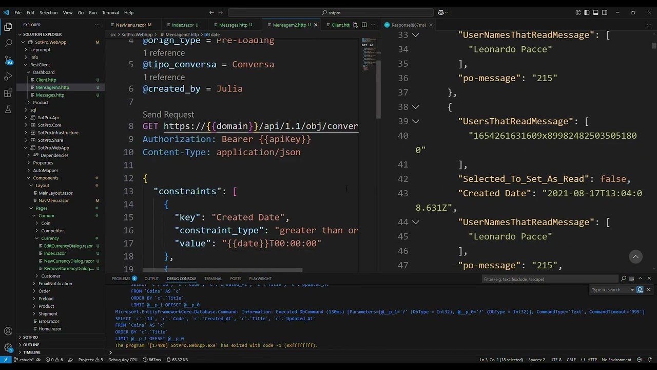

I put the link below to show the functionality about the GET call and appearly works as it should do.
But, unfortunality, we can see in this video that the constraints does not work properly.
I set up some fields in json fields, but the fields don’t appear.
I filter by date, but the GET show all records ignoring all constraints set up.

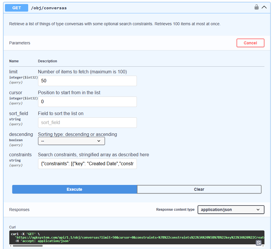

I used swagger and the tool sent this urls as json
https://agksystem.com/api/1.1/obj/conversas?limit=50&cursor=0&constraints={"constraints"%3A%20[{"key"%3A%20"Created%20Date"%2C"constraint_type"%3A"greater%20than%20or%20equal%20to"%2C"value"%3A%20"{{date}}T00%3A00%3A00"}%2C{"key"%3A%20"Created%20Date"%2C%20"constraint_type"%3A%20"less%20than%20or%20equal%20to"%2C"value"%3A%20"{{date}}T23%3A59%3A59"}%2C{"key"%3A%20"OrignType"%2C%20"constraint_type"%3A%20"text%20contains"%2C%20"value"%3A%20"{{orign_type}}"}%2C%20{"key"%3A"TipoConversa"%2C%20"constraint_type"%3A%20"text%20contains"%2C%20"value"%3A%20"{{tipo_conversa}}"}%2C{"key"%3A%20"Created%20By"%2C%20"constraint_type"%3A%20"text%20contains"%2C%20"value"%3A%20"{{created_by}}"}%20]%2C%20"limit"%3A%20100%2C%20"cursor"%3A%20"next_cursor_value"%2C%20"fields"%3A%20[%20"OrignType"%2C%20"TipoConversa"%2C%20"Created%20By"%2C%20"Created%20Date"%2C%20"mensagem"]%20}
The Response Body below brought 50 registers without the fields that I asked and not filtered as I asked too.

You are not settings your constraints correctly in the field in swagger… you need to remove the first part {"constraints": and the last }

{“constraints”: [{“key”: “Created Date”,“constraint_type”:“greater than or equal to”,“value”: “{{date}}T00:00:00”},{“key”: “Created Date”, “constraint_type”: “less than or equal to”,“value”: “{{date}}T23:59:59”},{“key”: “OrignType”, “constraint_type”: “text contains”, “value”: “{{orign_type}}”}, {“key”:“TipoConversa”, “constraint_type”: “text contains”, “value”: “{{tipo_conversa}}”},{“key”: “Created By”, “constraint_type”: “text contains”, “value”: “{{created_by}}”} ], “limit”: 100, “cursor”: “next_cursor_value”, “fields”: [ “OrignType”, “TipoConversa”, “Created By”, “Created Date”, “mensagem”]}
Would it be this?

What should be sent is the part for the constraints only. Actually, you are also mixing other keys (probably because you tried in JSON)
[{"key": "Created Date","constraint_type":"greater than or equal to","value": "{{date}}T00:00:00"},{"key": "Created Date", "constraint_type": "less than or equal to","value": "{{date}}T23:59:59"},{"key": "OrignType", "constraint_type": "text contains", "value": "{{orign_type}}"}, {"key":"TipoConversa", "constraint_type": "text contains", "value": "{{tipo_conversa}}"},{"key": "Created By", "constraint_type": "text contains", "value": "{{created_by}}"} ]
Is what need to be sent in constraints key
https://agksystem.com/api/1.1/obj/conversas?limit=50&cursor=0&constraints=%5B%7B%22key%22%3A%20%22Created%20Date%22%2C%22constraint_type%22%3A%22greater%20than%20or%20equal%20to%22%2C%22value%22%3A%20%22%7B%7Bdate%7D%7DT00%3A00%3A00%22%7D%2C%7B%22key%22%3A%20%22Created%20Date%22%2C%20%22constraint_type%22%3A%20%22less%20than%20or%20equal%20to%22%2C%22value%22%3A%20%22%7B%7Bdate%7D%7DT23%3A59%3A59%22%7D%2C%7B%22key%22%3A%20%22OrignType%22%2C%20%22constraint_type%22%3A%20%22text%20contains%22%2C%20%22value%22%3A%20%22%7B%7Borign_type%7D%7D%22%7D%2C%20%7B%22key%22%3A%22TipoConversa%22%2C%20%22constraint_type%22%3A%20%22text%20contains%22%2C%20%22value%22%3A%20%22%7B%7Btipo_conversa%7D%7D%22%7D%2C%7B%22key%22%3A%20%22Created%20By%22%2C%20%22constraint_type%22%3A%20%22text%20contains%22%2C%20%22value%22%3A%20%22%7B%7Bcreated_by%7D%7D%22%7D%20%5D

by the way, greater than or equal does’t exist as an operator. You need to use greater than…
Example with the create date only set:
and that is working:
https://agksystem.com/api/1.1/obj/conversas?limit=50&cursor=0&constraints=[{"key"%3A%20"Created%20Date"%2C"constraint_type"%3A"greater%20than"%2C"value"%3A%20"2021-01-01T00%3A00%3A00"}%20]
I fixed the problems about the variables I did not see before.
The json was this way:
{“constraints”: [{“key”: “Created Date”,“constraint_type”: “greater than”,“value”: “2025-03-13T00:00:00”},{“key”: “Created Date”,“constraint_type”: “less than”,“value”: “2025-03-13T23:59:59”},{“key”: “OrignType”,“constraint_type”: “text contains”,“value”: “Pre-Loading”},{“key”: “TipoConversa”,“constraint_type”: “text contains”,“value”: “Conversa”},{“key”: “Created By”,“constraint_type”: “text contains”,“value”: “Julia”}],“limit”: 10,“cursor”: “next_cursor_value”,“fields”: [“OrignType”,“TipoConversa”,“Created By”,“Created Date”,“mensagem”]}
I change the date filter with “greater than” and “less than”.

I change the date to 2025-03-13 in your example and worked here.
https://agksystem.com/api/1.1/obj/conversas?limit=50&cursor=0&constraints=[{"key"%3A%20"Created%20Date"%2C"constraint_type"%3A"greater%20than"%2C"value"%3A%20"2025-03-13T00%3A00%3A00"}%20]
