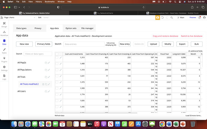

I have sort of similar problem and I am hoping one or more of you can help.
I want a dropdown to select an entity from my database. I was able to do that because all entity names are in one column of my database so all I had to do was to look for unique elements in that column.
The second dropdown is for selecting what metric I want to see. This is where I am struggling to even think how to look for it. I don’t see any option that lets me look for column names in the database (ideally, I want this dropdown to show only the names of my metrics but not entity name or period).
I am attaching two screenshots if that helps you help me. Thanks!
