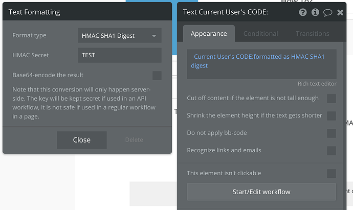

Also, I tried to use HMAC SHA1 for decoding and encoding and display decoded text with :formatting that is build in Bubble but I get this value “HMAC Digest computation on the client” instead of decoded text. What am I missing here?
What you are missing is that it is not secure to run the HMAC algorithm on the client side (in the browser) so Bubble throws that error when you try that.
The computation should be done in a server side workflow (API Workflow).

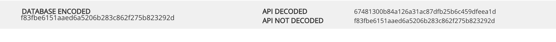

Hey @keith, I was able to set this up but I was having a problem actually decoding the text with an api call.
I have a text “12345” that is SHA1 encoded with a secret “TEST” = f83fbe6151aaed6a5206b283c862f275b823292d
When I run an api call it’s not decoded correctly. Is this the right way to do decoding on the server side?
Can’t tell from this image. What you want to do is return decrypted string of encrypted data, using the encryption key.
Are you doing that?
I think so but I might be missing something. I will send you a PM and maybe you can take a look.
Maybe I’m getting this wrong and SHA can not be decoded? I don’t know much about decryption so maybe that is the issue.
