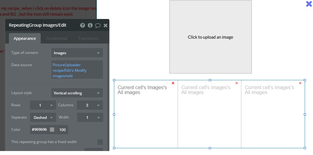

Delete image not disappear from repeating group
when i upload new image and added it to the existing old images ,it works fine and display on the repeating group and saved to the database BUT , if i click on the delete icon , the image successfully deleted from the database BUT the image show that it is empty [ not delete but act as it hidden ] for example if the total image number in the repeating group was 3 and after i click on the delete icon [ without close the pop up ] the image will disappear from the database and from the repeating group but the icon [delete ] will remain exist and the repeating group will still count 3 images not 2 [ even after i delete the mage ]
Note : After i refresh the page or close the image the delete icon behave correct !!
any help really appreciated , i need to understand why when i click on the delete icon the image not removed from the repeating group !!!

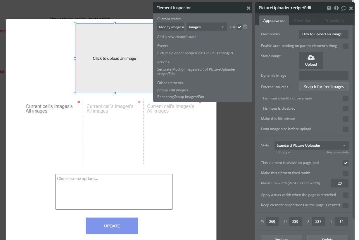

Thanks a lot for the idea @ danielolssontrbg87 , how i can restore the custom state to " default / empty " , i made the custom state looks like this , but it is also not working !
Note : if i use in the work flow " delete current cell’s images , it works correct only if i close the popup or refresh the page !

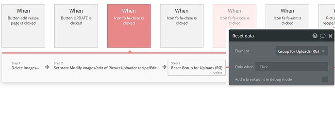

@luke2 i have removed "upload file " from the work flow , and select " reset Group " option as in the screen shot and it works fine , Thanks a lot for your help and support
Your welcome. Yes it was the reset action that needed to be present and of course the set state minus the item. The deleting of the uploaded file is an added workflow thats not necessarily needed, but go house keeping.
As for the delay you could trigger a custom event to run in the background or an easier way is to show then hide an animated gif of a trash can action, I sometimes do this.
