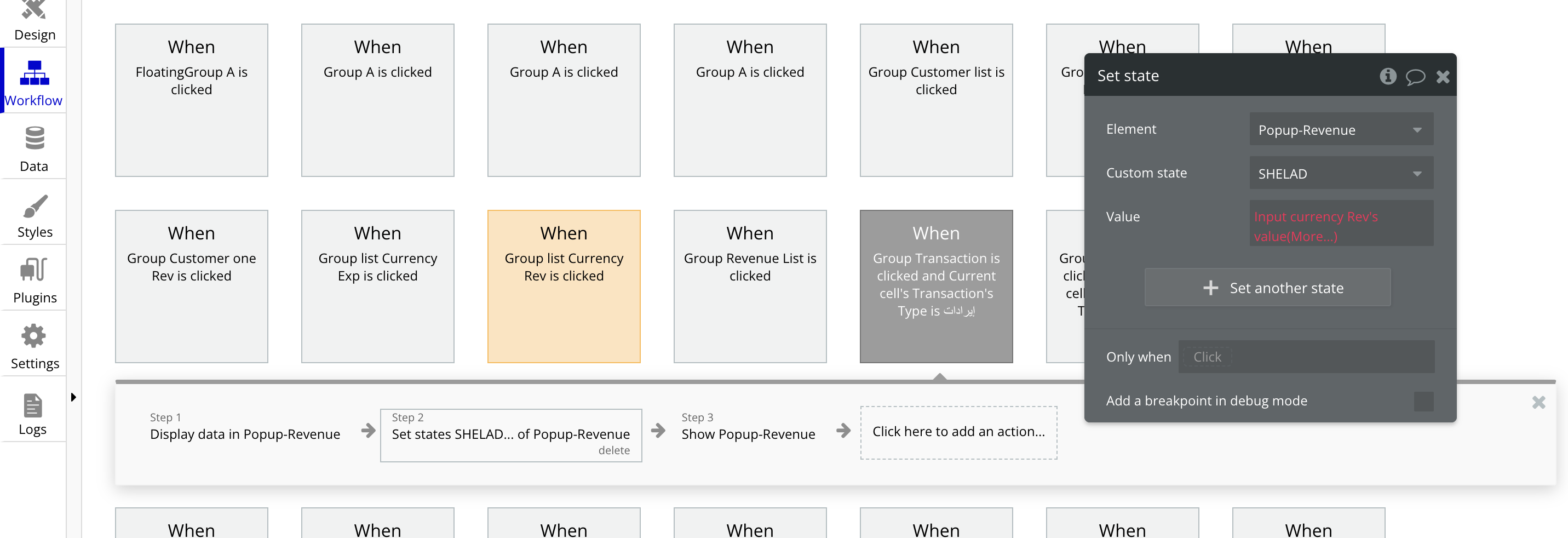

I have an RG, and one of its inputs is a custom dropdown list (working by custom state) but when I come to display the data in order to edit the RG, I can’t set the custom state to be equal to the existing value in the database, is there a way to solve that?

when I create a new thing in the RG by the pop-up, one of the inputs in the pop-up is filled by the custom dropdown list (work by custom state), till here is ok. but when I want to edit the RG, I need to display the data in the pop-up. and I need to set the custom state to be the existing data that was created the first time, but when I try doing that, I got red color as in the attached photo which means there is something wrong.

You are giving a Option set at the place of a Text that why its giving an error. and your using a Focus group for dropdown, i suggest you use a dropdown , it will save you from lot of Workflows and make you app less complex.

I solve the issue, kindly check it and confirm it, you are trying to set the currency category ( which is an option set) into another custom State. but from where you are trying to get the option set is only that OP display text,
so what I did, I search all OP and filter out only one which has an input display.

now when your custom state is set, you can compare both and change the color. :wink:

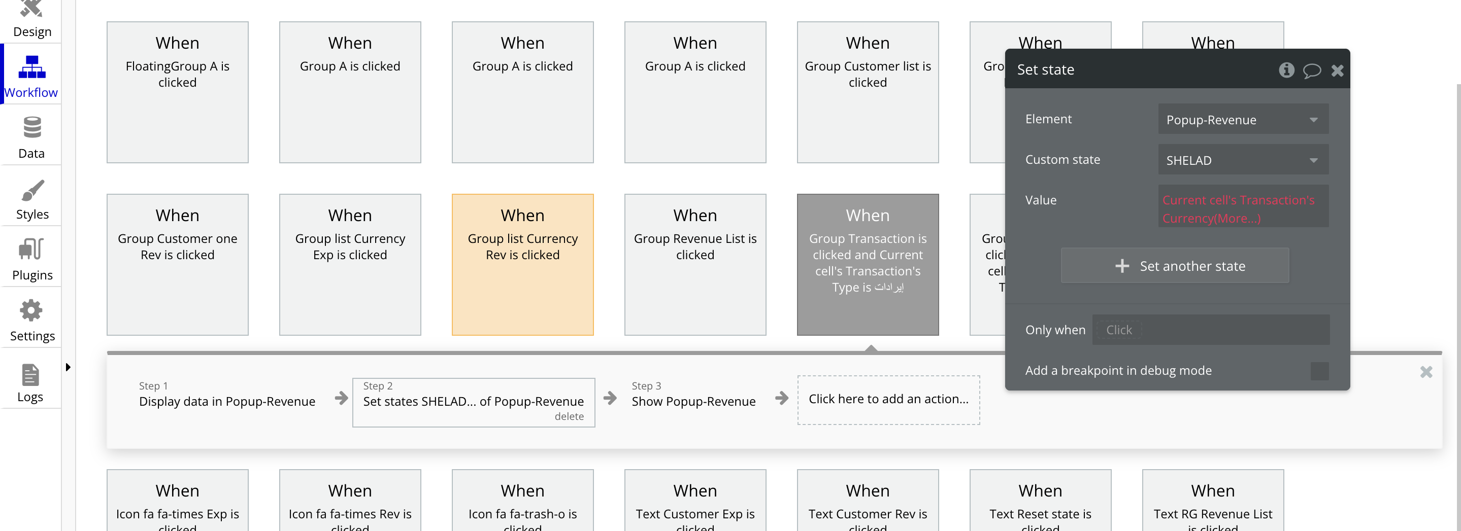

Thanks for your efforts bro, when I click the RG item, still shows me the default value for the custom state currency instead of the value of that transaction.

i have share a meeting link in message let discuss it, maybe i be helpful to you, i have few minutes to spare. :smiley:
Thank you so much Baloshi, It worked now. My Regards :+1:
