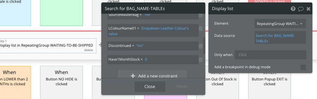

The second way would be to add an additional field on the BAGS datatype to record the difference between the total stock and monthly sales, and then you can simply search for items where that field value is negative. It will be much faster (especially with a lot of data) but will require some extra workflow steps to set the data.

Thank you already done the extra field but I am fascinating by the advanced filter, where about do I set this if I want to add that filter?
It’s part of the expression builder. Click in your expression (Search for BAG) and select the :filter operator. Then you can select the Advanced option, which lets you write a filter expression that will let you examine the properties of each item.
Ok great found it, I guess I can see now the advanced filter being more slow than adding that extra field as the search brings many more results that then get subsequently filtered where with the extra filed the results come straight away and they do not need to get further filtered…
