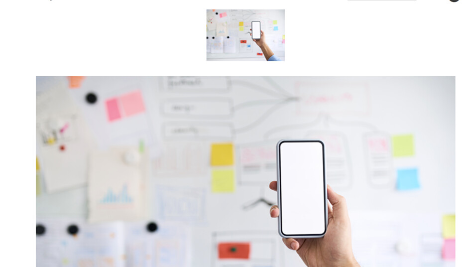

Here’s an example of a two-cell RG with an image in each cell within an HTML element (without any width or height properties set); the first image’s dimensions are 157 x 104 and the second 843 x 563:
These aren’t responsive, so a person would need to add certain HTML properties (width, height) to the HTML element to make them responsive, but this is the starting behavior.
