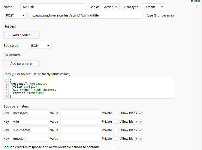

Hey @MattN, thank you for you answer. Just tried it. It works but not with a streaming response as the format returned by the backend workflow is type text and not text stream. I’m gonna try calling it from the API connector and ask for “stream” again. Let’s see…
Have you tried changing the option to streaming on the api connector?
Yes, I have a type “stream” both on my API connector and the “return data from API” custom type in the action. But it returns nothing. I just wonder if I’m using correctly the “return data from API” custom type field…
