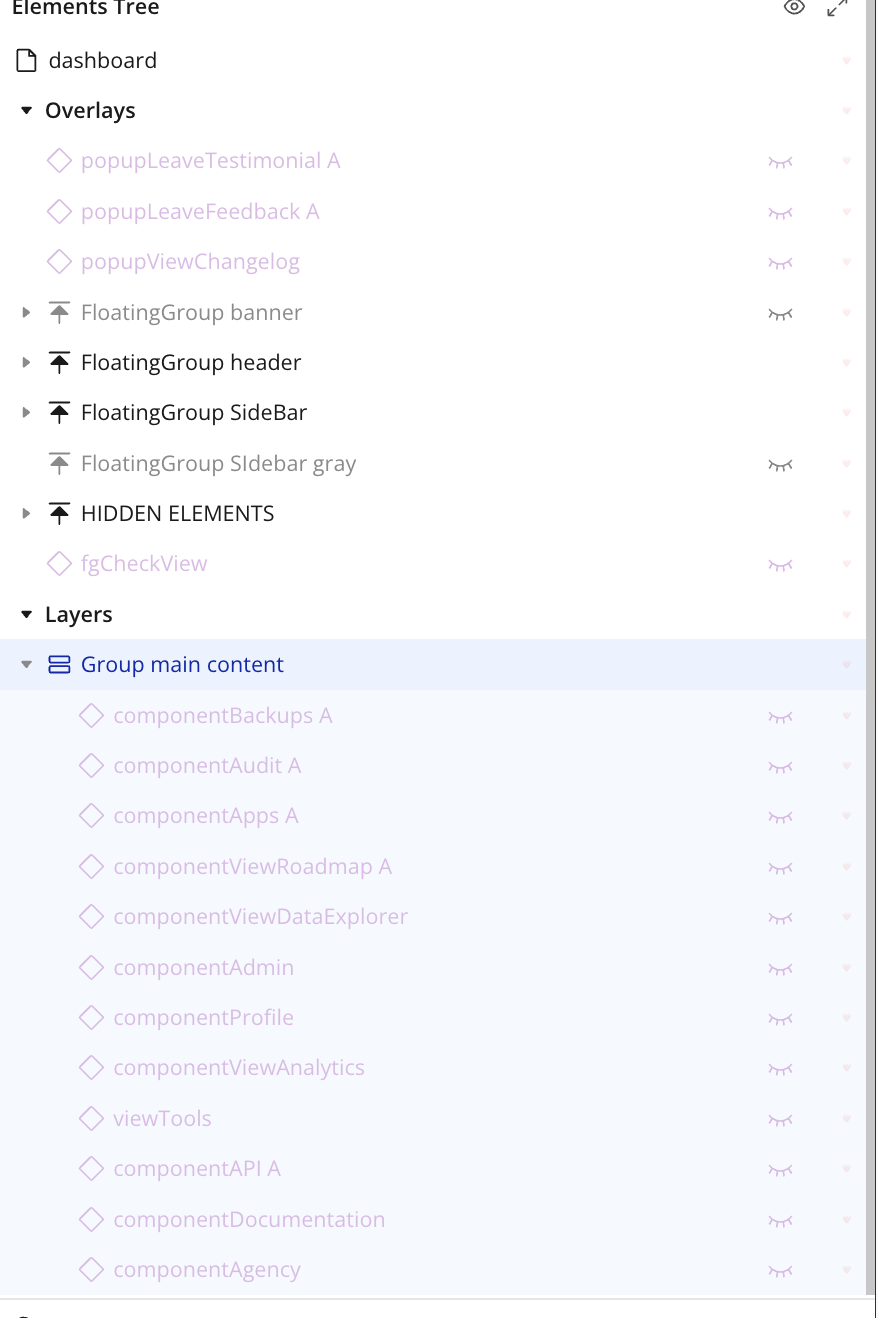

NQU Secure /dashboard page elements tree
Huge, will also make it a lot easier to tactically snipe errors in buried groups or elements. I’m hoping I can just use the convert to reusable function to quite quickly switch this up in my editor.

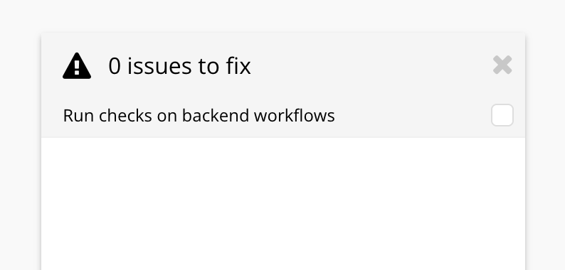

Also just throwing this out there, adding &issues_off=true to your editor URL will disable the checker entirely and can speed up things, but your also working without error checking so be mindful to remove it and check for errors after working.
