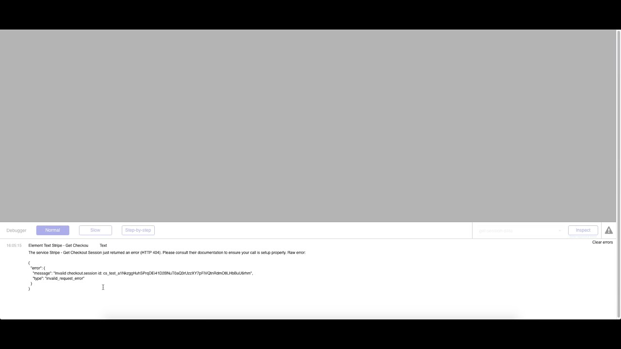

I have setup a Get call for a Stripe Checkout Session. Inside of the API connector I have initialized the call and it works, the raw response data comes back as expected.
For testing purposes I set the parameters of Checkout Session ID and Stripe Account ID to be Private.
When on the page attempting to use the Get call that was just initialized I get a 404 error saying the checkout session ID is not valid.
Everything is in test mode…I’m in the version test of the application. In the video I demonstrate the initialization of the API call and the setup on the page and the attempt to use the call followed by the error in the debugger.
Getting the same error. Did you find a solution to this?
I think it was because Bubble defaulted to the value set in the API connector and that value was not a valid value for a checkout session. Had to use a valid checkout session value.
Thanks for getting back to me.
By valid checkout session do you mean from a session in production?
If you are using your live version and having issues then yes…I was having issues in my development version so I was looking at test data from stripe
I’ve been only working with my test versions.
I’ve used the parameter [id] but that did not work either.
Any idea what I should do here?
Make sure there is an actual checkout session with the ID you specify in the account you specify.
Appreciate you so much! I had to look at Stripe logs and pull the account through there. The account id through the api docs was not correct
