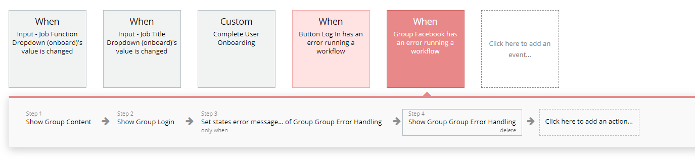

I added a workflow to catch such errors and handle them in a more user-friendly manner as shown below:
Yet when I trigger this error, the workflow shown above is not triggered. Instead I get the generic error that looks like this:
Any ideas as to how I can trigger this workflow so I can handle this error in a user friendly manner?

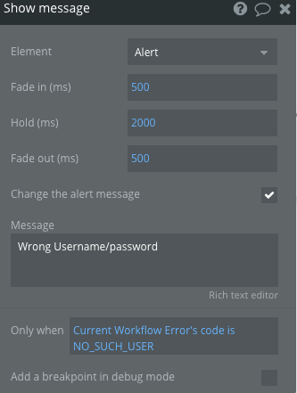

Use this - NO_SUCH_USER trap
@melon, thanks for the suggestion.

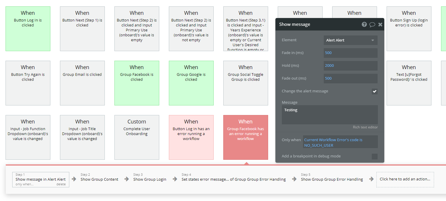

I tried adding the workflow action you suggested to my “error running a workflow” workflow as shown below. This didn’t work. Still the same issue. The “error running a workflow” workflow is not triggered so the action contained therein isn’t triggered either.
So I tried adding it to my workflow that generates the error (i.e. my login/signup with facebook workflow) but the “current workflow’s error code” conditional is not a valid option for normal non-error workflows as shown in screenshot below.
Any other ideas?

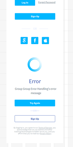

Also, I’d like to show an error group (not a popup or alert). I have a column with collapsible groups that contain all of my login functionality (e.g. social login, email login, loading spinners, error handling, terms and conditions, etc) as shown below. That works for other errors so I’d like to try to use that approach for this error type so I can keep things simple and consistent.

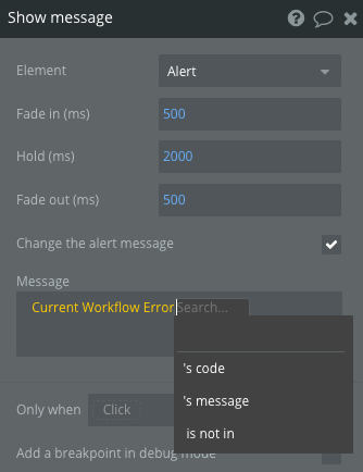

I put an alert element and called Errors workflow
Your error code will be USED_EMAIL

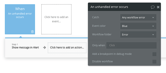

Using an unhandled error was able to catch the facebook error. This is better than having a “when ____ has an error running a workflow” approach because I want to handle all of the login errors in a consistent manner and don’t want to have to design different error workflows for email, FB and Google logins. Thank you!
