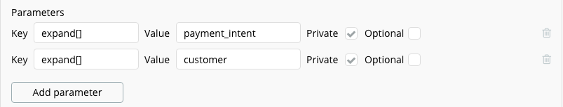

Have you implemented the expand object in a Stripe Get Call?
I’ve been able to do it for a single properties as well as expanding multiple levels
Screen Shot 2021-05-07 at 3.53.21 PM
Screen Shot 2021-05-07 at 3.53.08 PM
But can not figure out how to request multiple properties.
I’ve tried setting it up like this below, and although the call is initialized, the raw response doesn’t show both properties…instead it only shows the expansion of a single property and it is always the second in the setup (in example below, it only shows customer object expansion)

Hi @boston85719 did you end up getting it sorted out? I’m stuck trying to expand a Stripe GET call and would appreciate the link to your tip post!
expand[customer] or expand[payment_intent]
Whatever field from Stripe you want to expand (if Stripe allows it to be expanded) would use the same approach expand[field_name]
