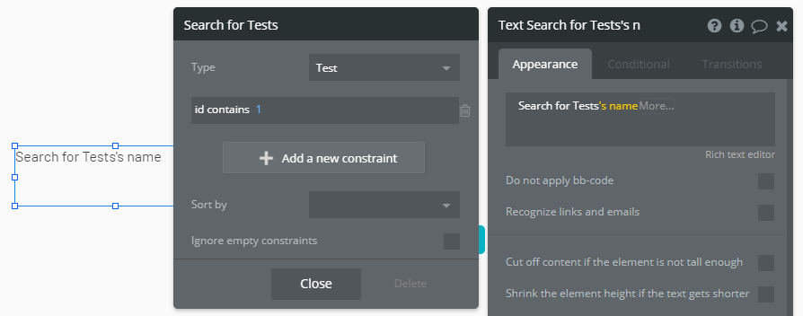

I have a table in my DB which is a list of things:
When I do this:
The resultant list is all four entries (I would have thought that only “Apple Pie” shows up):
When I do this:
The resultant list is the same as above.
I also tried filtering based on the name field which returns a blank list.

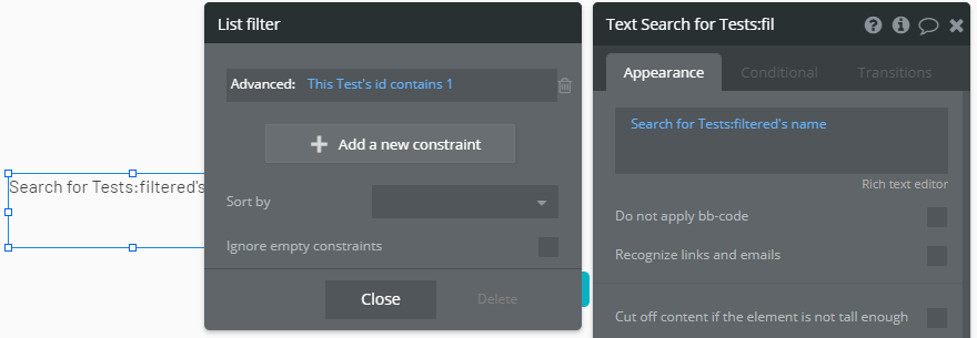

I tried advanced filtering:
Which also returns a blank list.
And when I try doing the same but based on the id field:
It returns the entire list again.

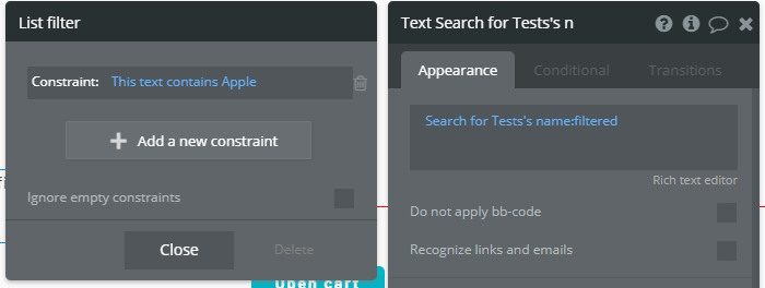

If the suggestion is to do this:
This isn’t an option for me because I need to return the name field by filtering based on the id field and the above filters the name filed based on the name field.
