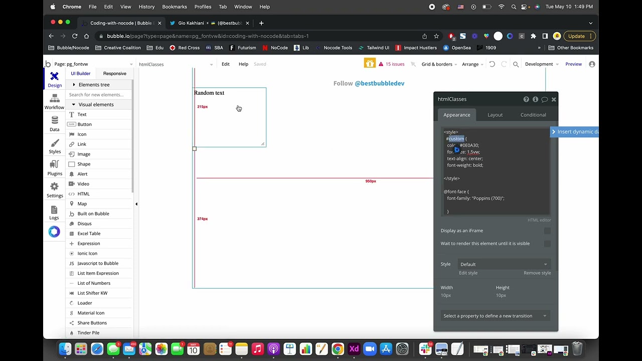

Here you go hermano Font Size = ViewPort

I found the @font-face didnt work… so I did this instead:
#hero-text { font-family: 'Poppins'; font-weight: 400; Color: #000 font-size: 5.5vw; text-align: center; }
Also, to really super charge this so you can reuse it over across the entire site :slight_smile:
Create a options set, call is something like ‘Font Styles’ - add a bunch of attributes, like: ID, Font Family, Font Weight etc - all the ones you need (you can add to it later)
Now create a reusable element and in that create a repeating group where you get the option set data.
Now in this you add the HTML element like above but you substitute with dynamic data from the option set.
After you have done that drop this reusable element in to a header, or just on the page and make sure you change the html elements ID attribute to pull from the option set you just created for the particular style you would like :slight_smile: COOL
