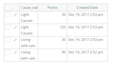

So as an example I have the following table:
sum by order
I simply want to Sum the points by name so the answer is:
Living with cats, 120
I know I can do a search for the name and sum values if I know what the search is, but the name is added by the user so there is no way of preempting the search parameters other than group by the names and sum the values.
