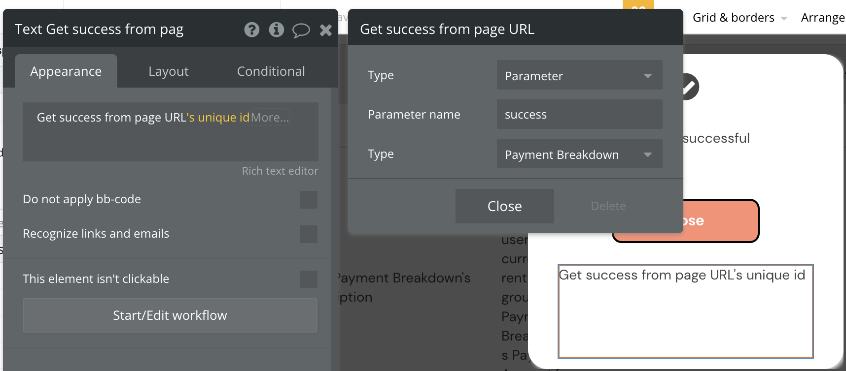

Thanks guys. The long number after success= is the unique id of a database item that I’m having displayed once returned from a successful stripe payment, there also isn’t any ? in the urls, so should I stick with parameters rather than paths?
Screenshot 2023-03-29 at 18.03.18

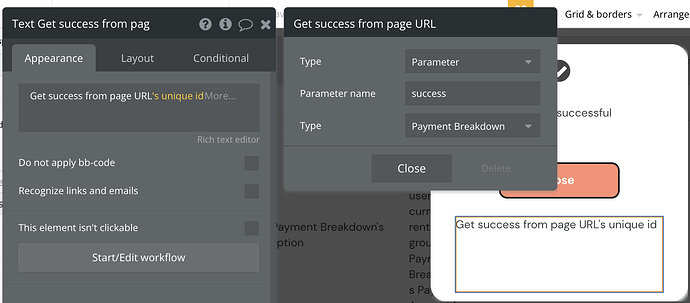

I made the change to remove each item’s unique id. The popup’s type of content is a ‘payment breakdown’ the same type of content that the unique id in the parameter is.
I’ve added the text element at the bottom of the popup to check that it’s working, but it still isn’t bringing in the things unique id for some reason…
Also, checked privacy settings and tried with privacy turned off too, but no luck
If your url doesn’t have ? then you’re not using query parameters…
So either get rid of the = and just use the path, or add ? to use parameters.
That’s the ticket, thanks so much!
