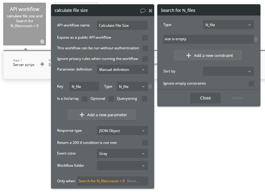

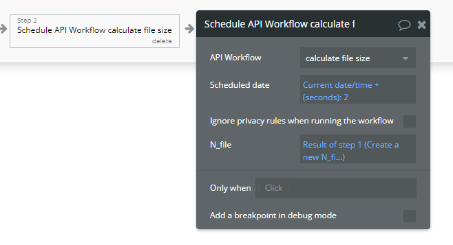

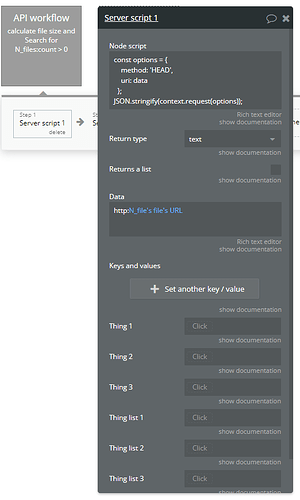

So I managed to do this with the following API workflow: (note that the actual field name I am using is called N_file, instead of User_File). I used the javascript Toolbox plugin to do a HEAD request (server script 1) that contains the file size in bytes and I extracted that info (server script 2).
And I just schedule an API workflow, either for each item separately, or I’ll call an API workflow for a list of things
(for a single item)
(for a list of things)

I am trying your solution but I get a 403 code error with my private files. When they are not private I get the size.
Any idea how to get access to the size of private files ?
I’ve been playing around to find a solution. To circumvent the 403 code error you need to remove the “http:” from the request. I noticed that this happens only on private files because there is a mediatory URL that is stored as an https: address which then leads you to the real address through some form of authentication. Since this mediatory URL redirects you to the real file you should be able to extract the file size from the mediatory URL if you manage to grab it. Thus, the HEAD request should be used on the mediatory URL and not on the initial URL. Maybe this helps you a bit in finding a solution. Right now I got my hands full so I don’t have the luxury to solve it. If you manage to crack it I would be interested in the solution you came up with.
Hi @BenjaminP
I already removed the http as in the private file rule there is already https.
I tried many things like adding a bearer token (i get error 401) or adding into the file url a token api (i get error 403)…
