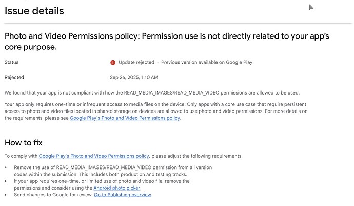

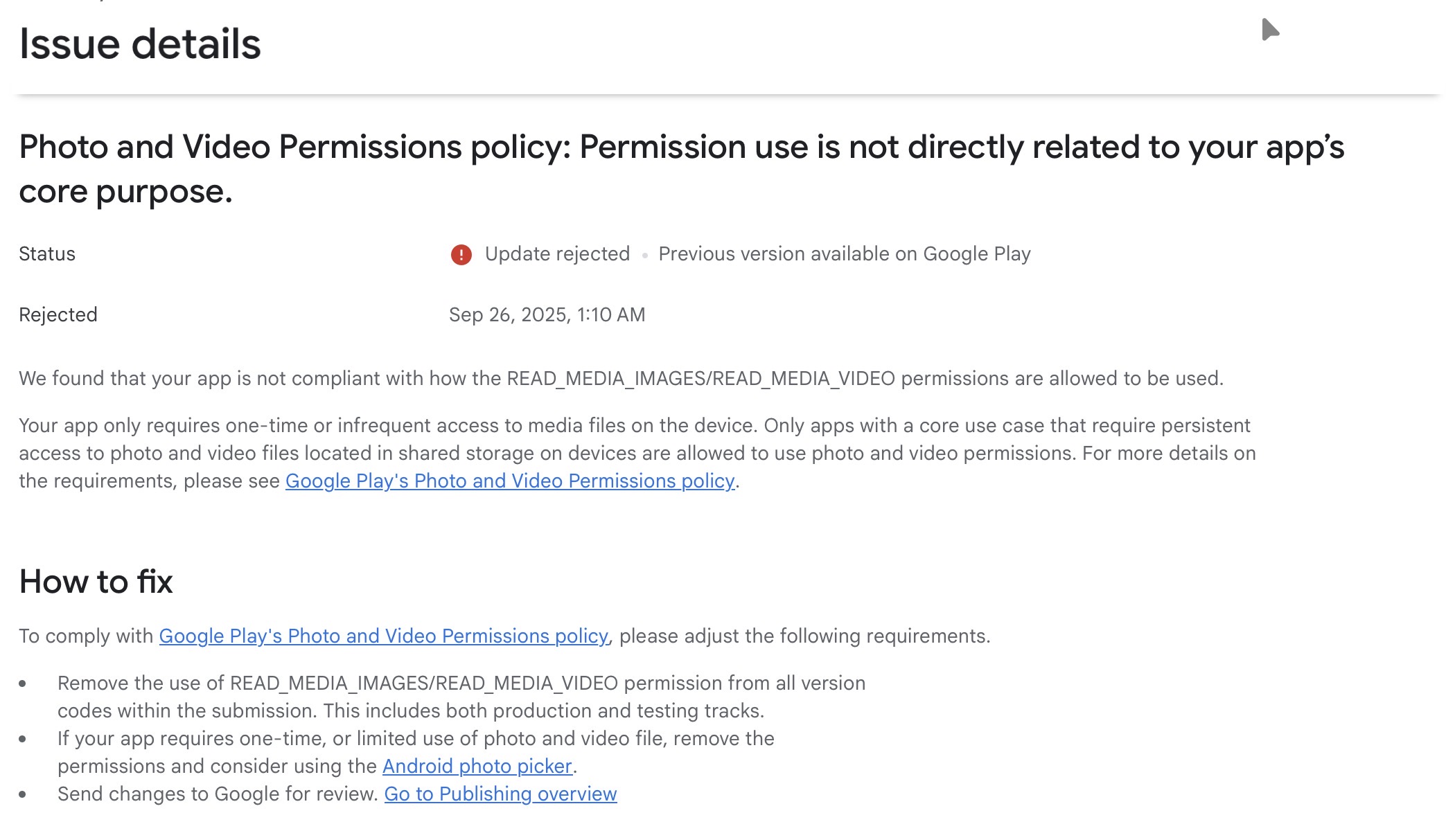

Google Play rejection due to READ_MEDIA_IMAGES / READ_MEDIA_VIDEO
Hi everyone,
I’ve built an app in Bubble that has already been approved and published successfully on the Apple App Store, but I keep getting rejected on Google Play.
The rejection message says:
“Permission use is not directly related to your app’s core purpose. We found that your app is not compliant with how the READ_MEDIA_IMAGES/READ_MEDIA_VIDEO permissions are allowed to be used. Your app only requires one-time or infrequent access to media files…”

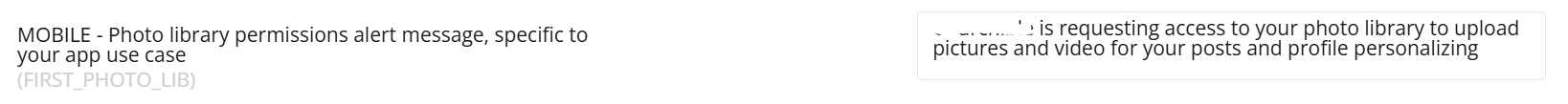

@tobixzybolumole I am not sur to understand the solution you mention, is it modifiying the permision text that appears on the pop up of the user ?
@quentindechabot
Edit the permission text in a way that demonstrates the app wouldn’t use the camera or video element consistently
Because right now, according to your description on the app, camera and video capture isn’t a or required as part of the core functionality of the app so Google wouldn’t let you deploy the app if you present your app in a way that appears users consistently using camera/video capture

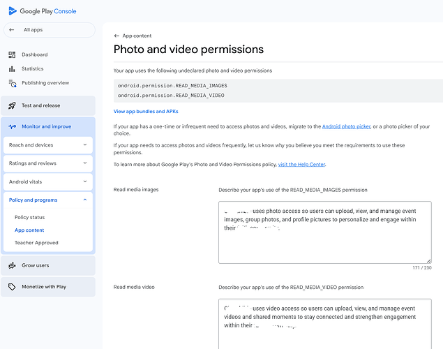

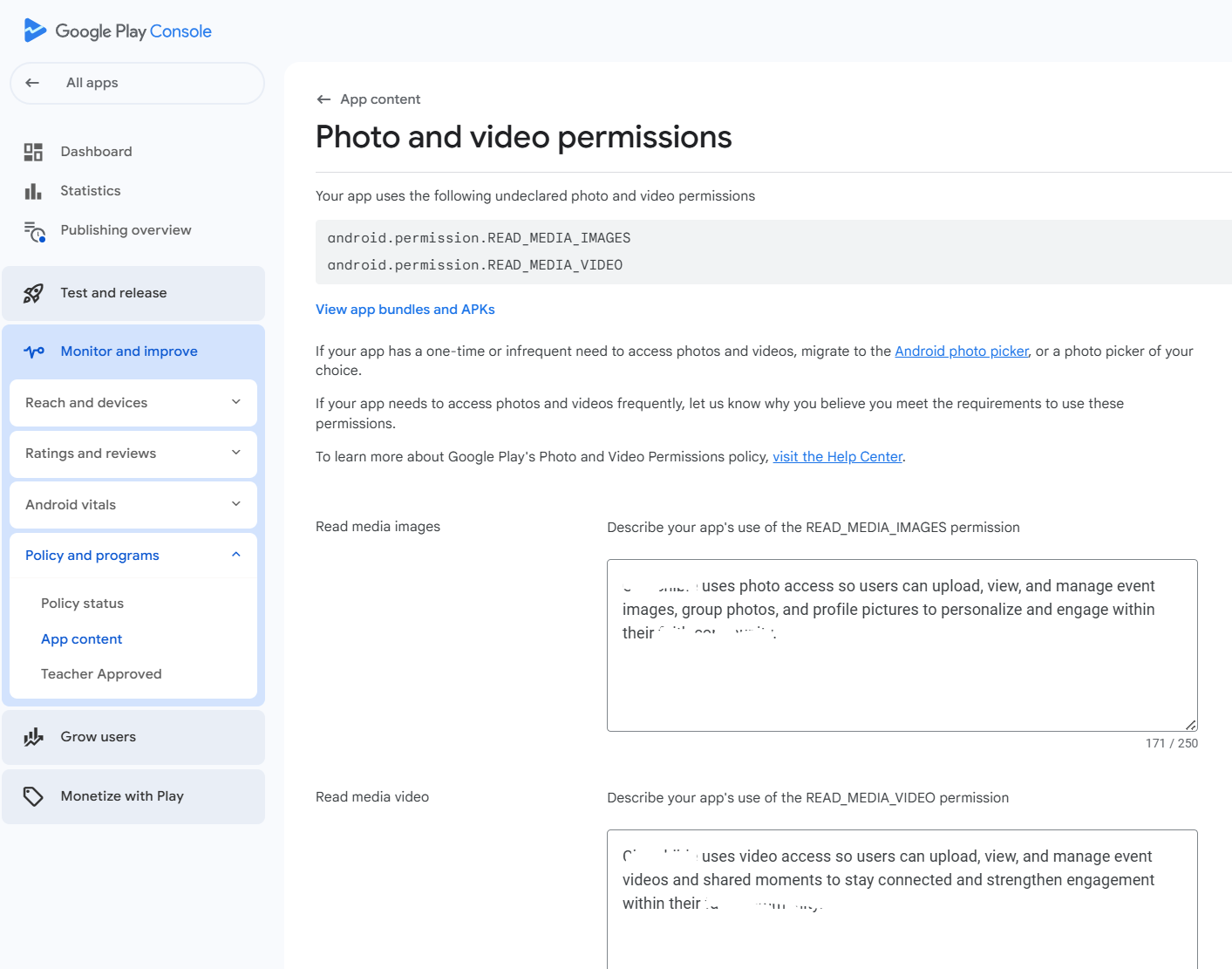

I am facing thesame problem. This is not our first build that is live. I dont know why this new version build update is flagged. @tobixzybolumole @nick.carroll Any recommendation?
have you been able to update your app permissions to what i stated earlier?
@tobixzybolumole This is what i have on my language settings
This is what i have on the Playstore policy
Where do i make this change?
P.S. Sorry i had to cover some details
I wil redirect you to my inital post, you can pick the first option
@miracle
We also are having this issue, I have rewritten the permission as suggested above and we were still rejected:
READ_MEDIA_IMAGES/READ_MEDIA_VIDEO is a restricted permission and apps must only declare this permission if their core functionality requires broad access to all photo or video files on the device. Apps that request this restricted permission are subject to review, and those that do not meet the acceptable use case criteria will be disallowed from publishing on Google Play.
